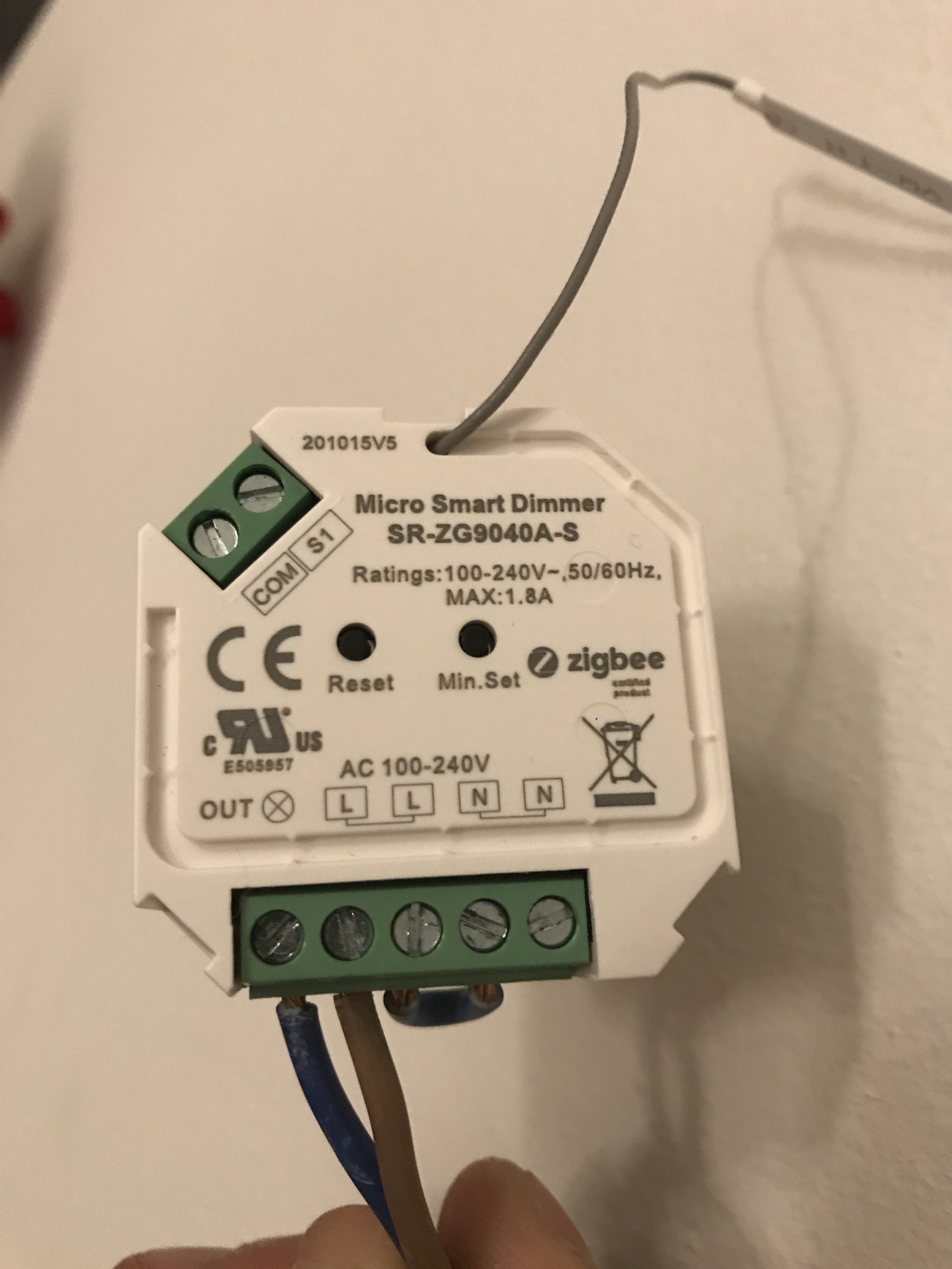

Yesterday I bought and installed the Sunricher 9040 (Zigbee dimmer installed in a 3-wire system). I had problems including it to version 4.2. So after a while I took the bald move to upgrade to version 5 experimental. Much easier to include. The problem is that it only being recognized as a ”basic zigbee device”
Added info 2021-01-22:
Product ID: HK-SL-DIM-A
Seem to be the same as the one of @Marius_Muresan. You do have to give the Device ID and Profile ID as well, or confirm its the same. Maybe with V5 you have to interview the device and give the info to @TedTolboom
https://developer.athom.com/tools/zigbee
Hi! Same ID’s… I got a long list of answers after the ”interview”

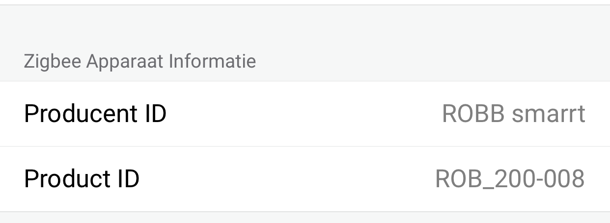

When it is paired as unknown or generic zigbee device, which product ID’s are shown in the app > generic Zigbee device > Settings > Advanced settings?
I’ve just released v2.1.1 to the app store test environment that should fix the issues with the Z-wave remotes (@Jot and @Mike1233 experience) and adds the missing productID’s (@Pelican, @Fagerstromc, @Marius_Muresan have requested).

Hello Ted,
This is the information.
Recently upgraded to the final homey version 5.0.0 and the Robb Smarrt app test version 2.1.1
Still no result.
René Slisser.
Thanks, fixed in app version v2.1.2.
