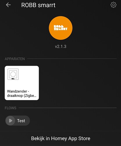

I came across a minor bug when testing the wireless zigbee dimmer. The dimmer value is being stored in a local tag instead of being linked to the device itself. Running homey v5.0.2

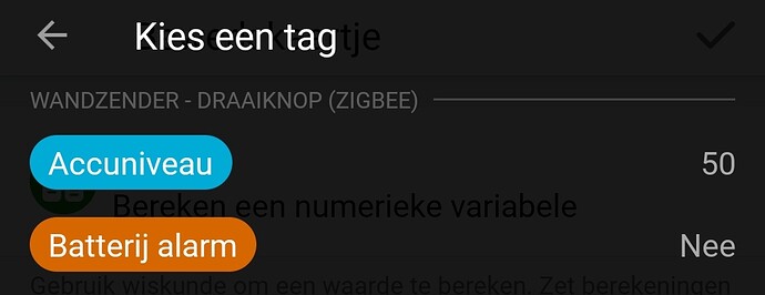

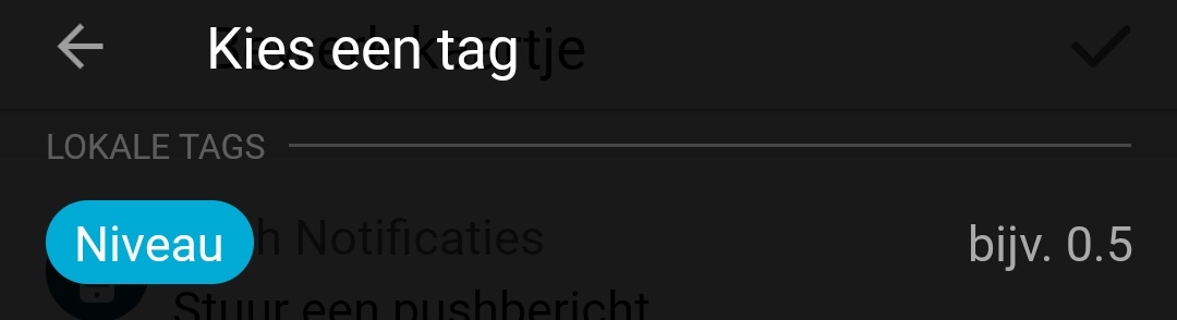

Some additional screenshots
Tag selection:
App:
So if you scroll down to the device itself it isn’t there?
“Local tag” only means it is attached to the trigger card you are using… So local to that flow.
I don’t see it, unless I’m missing something completely :

That’s not a bug, but intended behavior.
Since the device is a remote, it does not have an own dim capability; you can’t set the dim value of the remote (as an own state).
The wireless dimmer acts as a remote, where the implementation within Homey is the flow trigger card. Therefore the dim value will only be available as a local tag, to be only used within flows.
I’m not aware of a limitation that the dim level only accepts a 2 or 3 digits behind the decimal point. I’ll verify and update the driver if needed.
Aha, I completely misinterpreted the way these variables work. Thanks for the clarification!
Thanks for checking the decimal value too.
