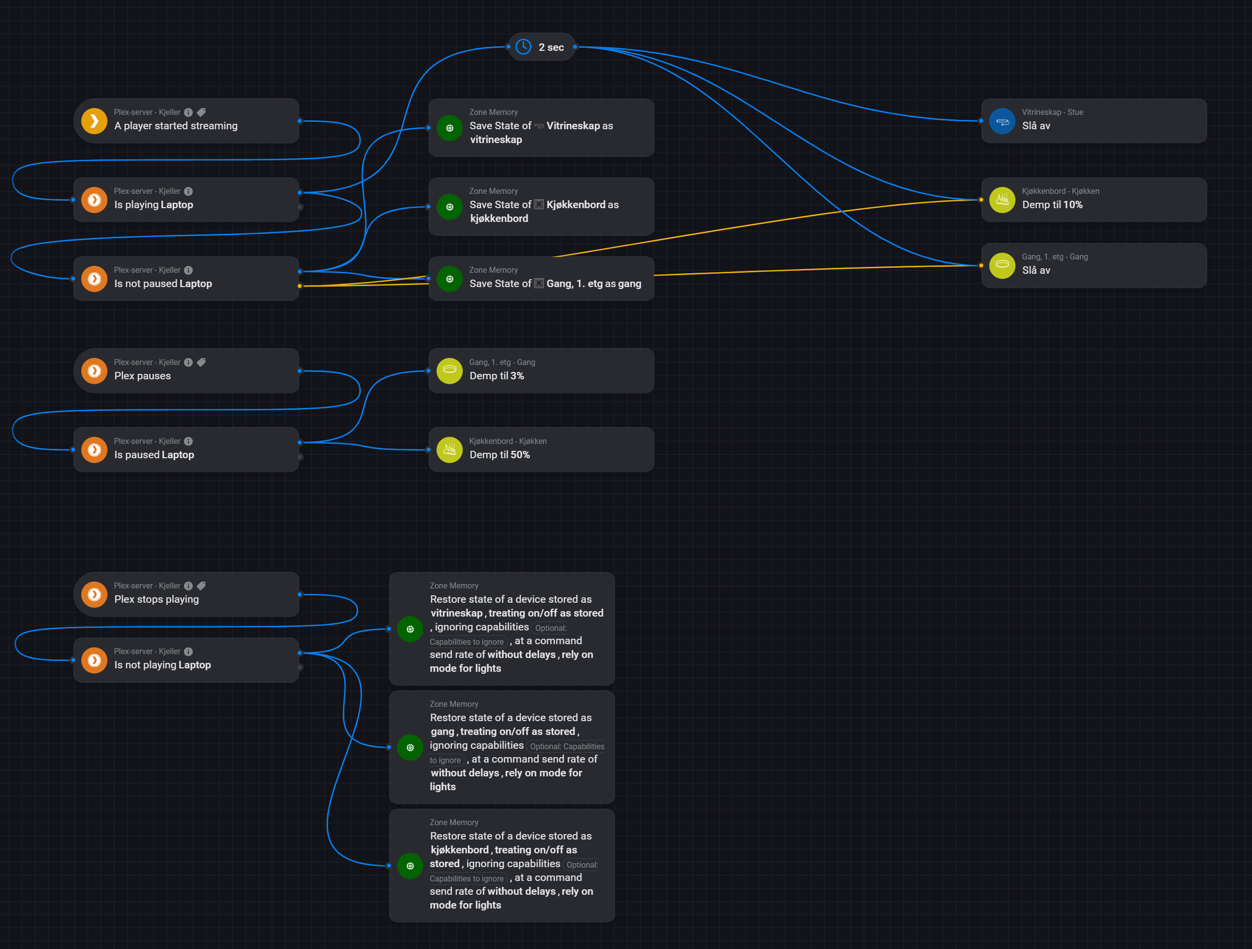

I’m trying to create my first advanced flow to control the lights when playing something with plex.
I want to save the state of three lights when i start playing.
Then i want to turn on two lights when i pause plex. (to have some light when i’m going to the kitchen or the toilet.) I also need them to turn back off when i resume playing.
Then lastly i want the lights to restore to the saved state when i stop playing.
So far I’ve got most of it working, but I cannot figure out how to turn the lights off when I unpause plex.
When I start plex, it saves the state and turn off the lights.
When I stop plex it reverts to saved state.
When I pause plex, two lights turns on, but when i unpause plex nothing happens.
I feel like I’ve tried everything. I’ve attached an image of where i ended up before I gave up.
