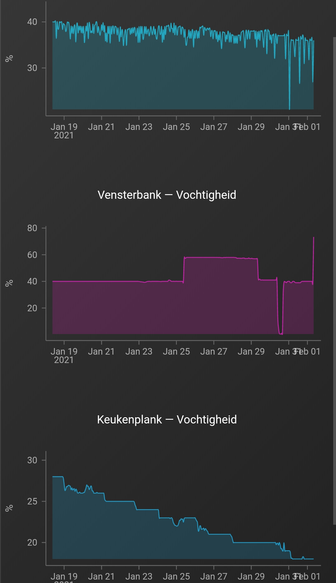

Removed the battery for an hour, replaced the battery removed the device, added it to xiaomi flora app (to see if there was an update, removed it from xiaomi flor app, added it to homey and it still had the same issues.
In de xiaomi app it displays the correct values.
My flora sensor is now submerged in water so it should read 100% but it stays at 7% now

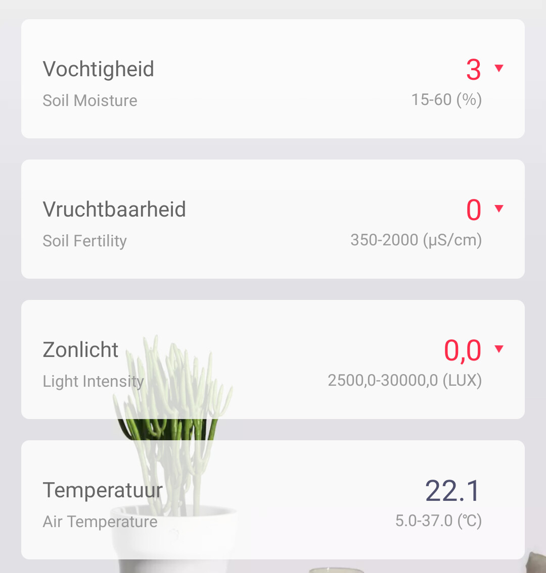

Removed and added to flower care in water:
Added to flower care out of the water:

It seems to got some data buffer? It holds on to the last values. Should I remove the flora app on homey and readd all the devices?
There is a difference in the the real-time data (app) and snapshot data (homey). Can that explain the behaviour? Or is the difference to high? You only have one sensor with that behaviour?
The real-time data was not working on the BLE implementation from Homey the time I made the app.
I can try if I can get this working on the latest 5.0 code.
I have no clue what causes it. In the flower care app everything works fine. But in de homey app it stays at 6 to 8%. I’ve 3 other sensors that work fine
