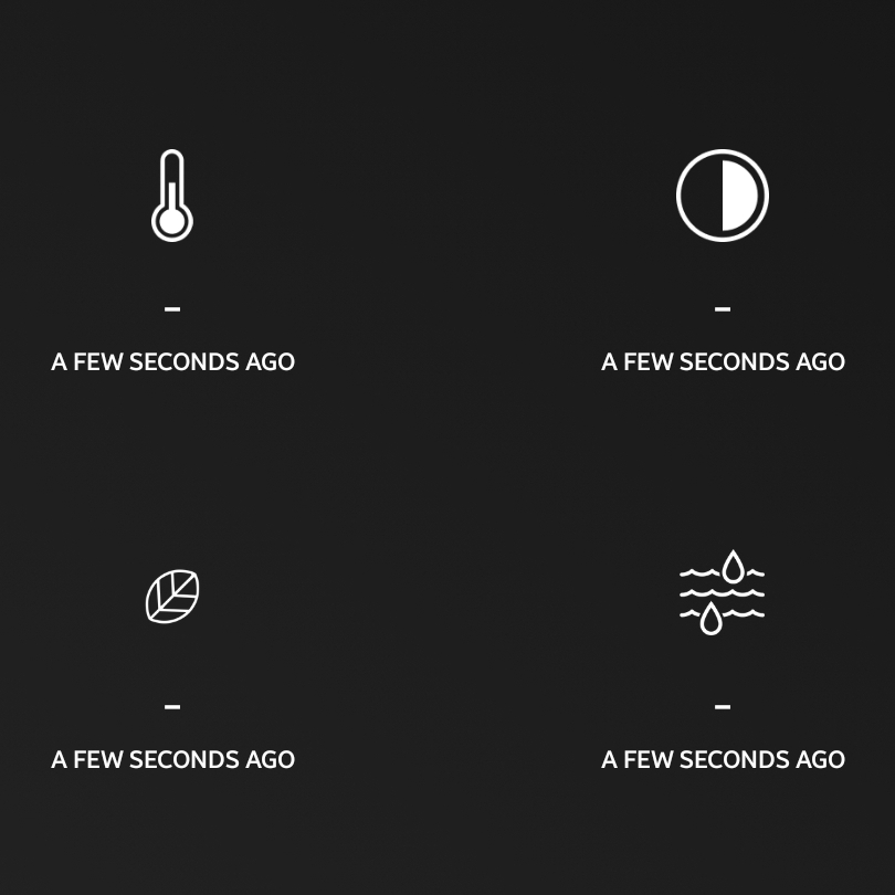

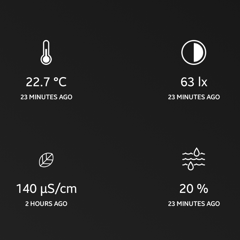

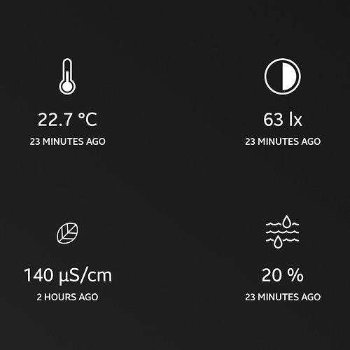

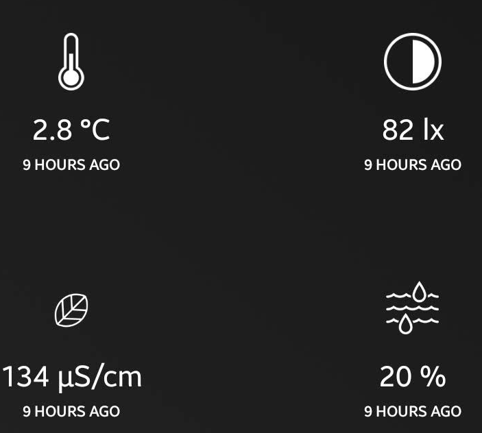

Sure, let me try it. For me, there are currently 3 issues.
  1. pairing - I bought 3 Xiaomi Flower sensors and I tried to add them - even all three sensors were nearby, always only 1 or 2 were available for pairing. Even when I paired two first, then tried to add 3rd - it wasn’t visible. I tried to remove them, update firmware, add them again, pulling out battery - no change. Then I read about app restart, so I have added first two sensors, restarted app, add successfully 3rd - but then data were not updating since pairing (even after several hours). So I restarted app again and it was already updating as per the interval set for the app (15min).
  2. updating values - since last few days, I had to restart the app even during the day to get the data updated.
  3. issue - now with new firmware v4.2.0-rc.6 even after I restarted the app, values are not getting updated at all. Maybe Athom broke something ?

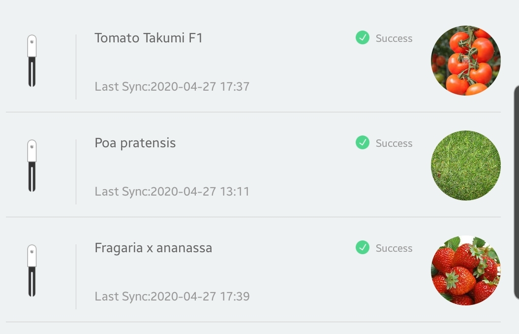

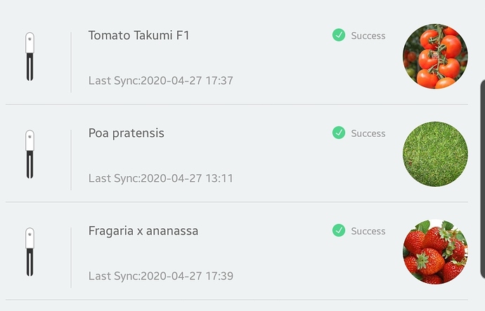

I changed sync interval to 30 min, in the meantime installed WatchFlower app (Android)… just to test sensors and it seems this apps sync better then the original one. Also I don’t know if it is related but now it’s syncing also in Homey. Coincidence?
Update day after - sync interval 30min, not updated now for 3 hours :frowning:
