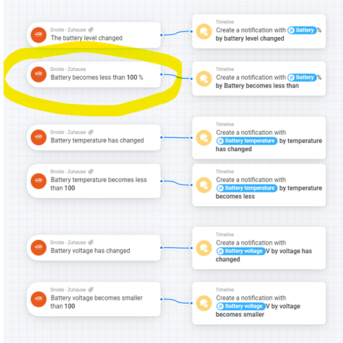

I investigated the problem mentioned above with:
The problem is that the highlighted trigger does not work properly when the battery level drops below the defined value, and therefore does not work with the polling. It works when the homey energy warning is triggered and a rare times during the day/night. Please check this.
The other triggers I tested above work pairwise in sync.
THX
something strange is happening. it always seems to take the GT trigger even for LT but only for this trigger, nowhere else, all code seems to be okay.
i have changed the flow assignment. But also readded my devices. So not sure what was the solution :-(…

Only the first set of changes includes the “battery becomes less” statement. In all other cloud push only the “battery becomes less” statement is missing again as in the screenshot above.
Could you go to the log and check to see if messages with LT or GT are shown
if GT messages are showing please readd the device
I readded the device and fixed all cards and variables.
Sorry, same result:
Only one set of changes includes the “battery becomes less” statement. In all other poll/push events only the “battery becomes less” statement is missing again as in the screenshot above.

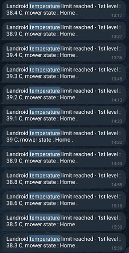

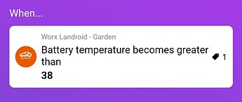

@Martin_Verbeek, would you know why this happens please? I thought I will get condition triggered once but seems it’s multiple times… isn’t there some rounding that could cause this ?
Also per insights it doesn’t seems to be going below 38C in the given time period…
rounding is not applied, will round to integer in next update
Thank you, but is this the cause ? I mean, the threshold is 38.0 so it should get fired only once when it is going above 38.0, or ?
see what you mean. Not that easy to fix with a rounding ;-).
