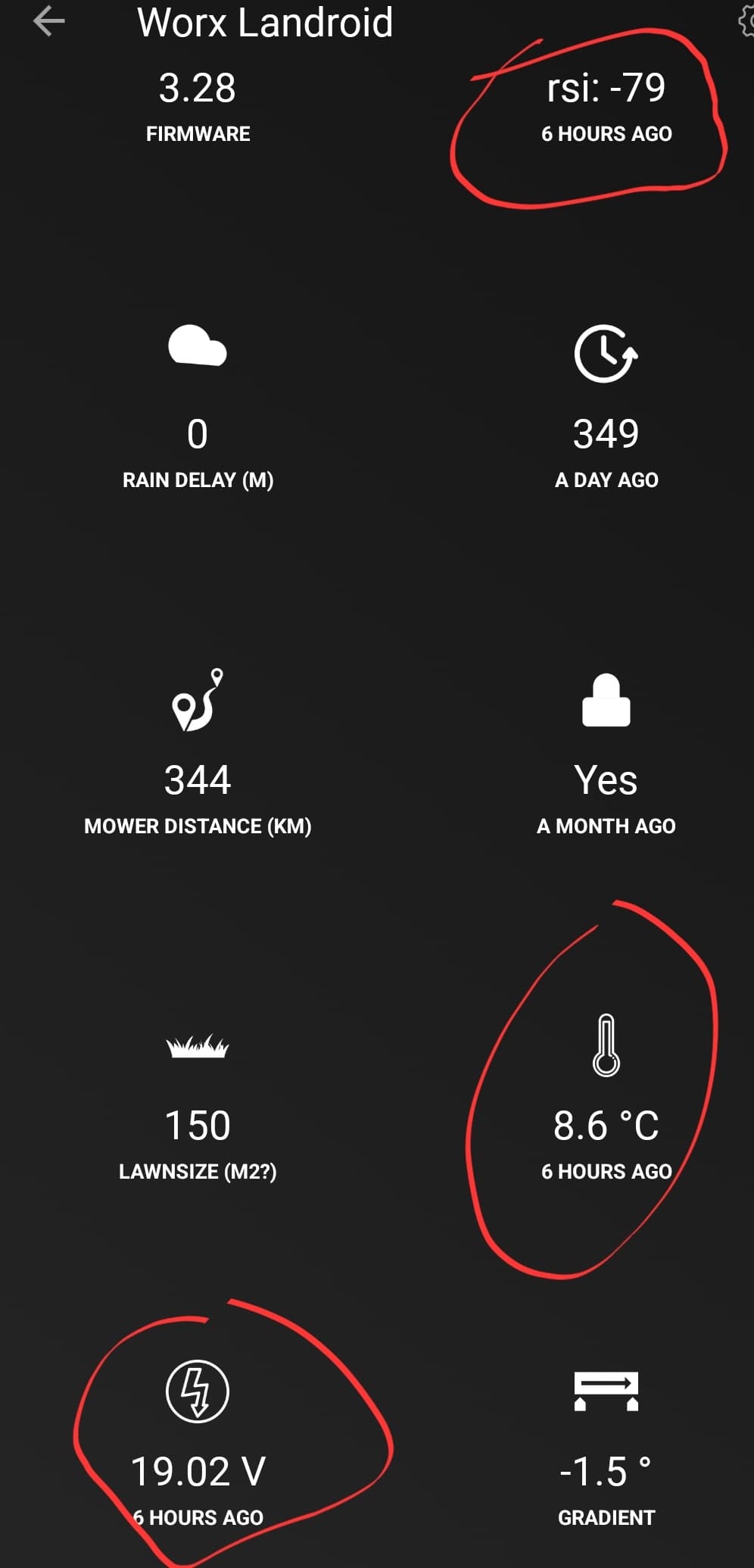

Hi Martin,

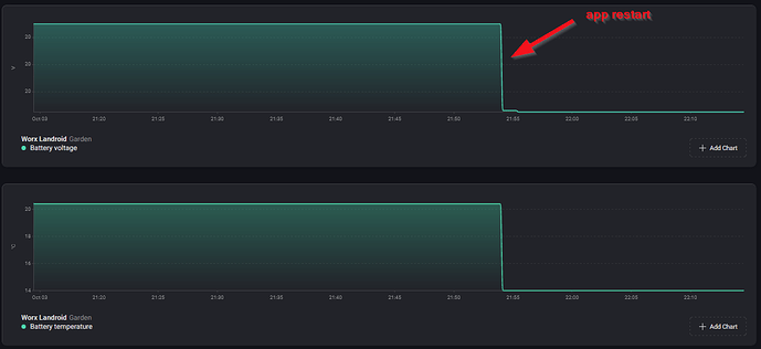

not sure but I just realized I had old/not updated data like temperature and voltage - I have performed restart and :
In the app log I see no error - I sent you diag. report - c01e7453-db38-487b-a200-8130b72f0f9b , if it helps anyhow.
Not sure it was just coincident, will keep eye on that.

Hi, well, last update 6 hours ago…maybe it’s some kind of sleeping mode? I’m not sure however if it wasn’t the case even before…
As far as I understand one of the changes with 3.28 is that worx doesn’t push all device parameter values with a frequency of 10 min anymore.
Source: sorry in german only #133, #140:
But you could use the poll card to force an update of the values.
You mean pulling from top to down in the original app?
