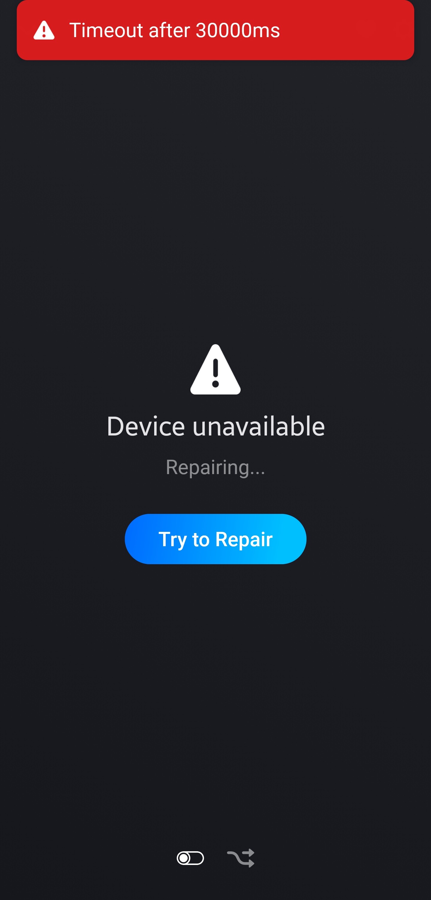

@Casper181 the report is empty. Looks like the app crashed. Can you check that?
9dc7fe7a-1352-4cc5-9b15-07322b789ef8
Restarted app. Immediately went for repair. Repair timed out. Hopefully not empty.
