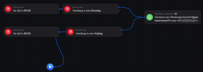

@EdNL please share your flow
This one
@EdNL you are checking if the number is +316000001AND +31600002. That won’t work make sure to put any card for those 2 cards
I don’t know how?
I really don’t get it anymore. It’s always been the way it is now. Only when I uninstalled WhatsApp and reinstalled it did my flow change (WhatsApp is gone). But I never changed anything else. Damn, I really don’t get it anymore.
@EdNL as said earlier try to debug it per card. That makes it easier than checking the whole flow at once. so try to remove some cards and see if it works then and build it up from there again.
No matter what I do, no matter how simple I make it, I don’t get a response from WhatsApp when I type something like “help homey” into WhatsApp. I don’t understand it; it always worked, and now it suddenly doesn’t. I’ve made it as simple as possible, and I still don’t receive a text message.
@EdNL Do you send a message to yourself or from another number to homey?
I send with my whatsapp on my private mobile, to a other whatsapp number on a other mobile.
@EdNL and other flows work?
Only the flows I allow to send information. For example, the 8:00 AM weather forecast or hourly electricity price information. But also sending notifications about doors being open via WhatsApp.
Only sending a WhatsApp number to myself to my Homey WhatsApp number (so two different numbers).
@EdNL so other flows work?
