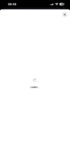

I don’t know what’s going on either. It keeps telling me to reconnect to WhatsApp, and when I do, I just see a white screen and can’t get any further. I now have to adjust all the flows again. Hopefully I still remember them, otherwise I’m out of luck.
@EdNL please send a report when this happens otherwise I won’t be able to check what’s wrong
Also if you keep seeing the white screen the repair doesn’t work and the only solution is remove and add it again. Not sure if you did that already
