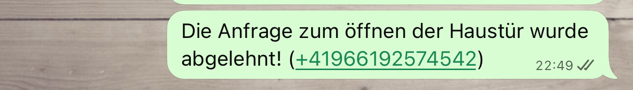

After seveal tries, it went thru… was timing out multiple times while trying to repair. Now its getting group messages, but the sender number is always wrong: +4196619257**** (i better hide the last 4 digits, maybe a dev forgot to remove his test number while debugging) … i do some automation, based on this where i also filter by phone number and with this number its not working anymore …

I just submitted a report. No, I live in Germany, and the number shown is completely random. I sent the message from my phone, which uses a completely different number. In WhatsApp, I can see my correct number, but when I forward the message as a push (in a Homey Flow), a strange number appears as the sender.
Report ID: 6157c7a5-6ce1-4912-be7b-16f3957db2ad
WhatsApp shows my name correctly in the group where I originally got the message. I have no idea where this other phone number is coming from.

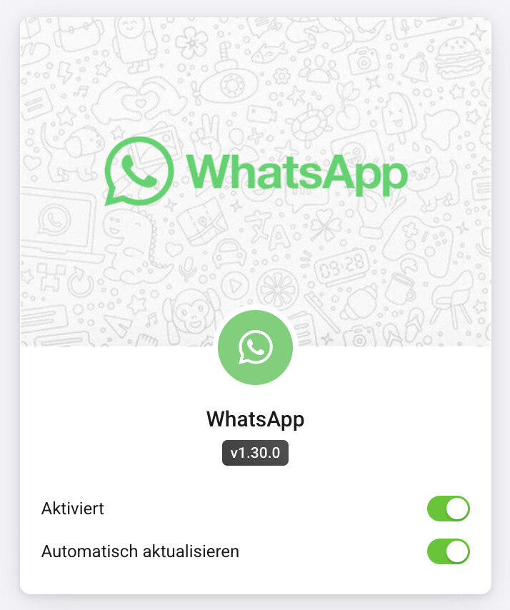

which app version are you using?
v1.30.0

Now it received a group message, but again from that wrong number, although i was sending it from a completely different number:
i created a new report, hopefully it contains trace where this number comes from: 739776af-6e1e-4c80-9595-28e0c3e701d2

Thas my personal number. I have my business number registered on the phone, but never used for WHatApp and it is also a german msisdn
It doesnt matter in what group i enter some text, it is always attaches a wrong phone number.
I tested with another families phone, andt there comes another wrong number:
Looks like, every WhasApp account is getting another wrong msisdn attached which seems to be persistent for this account. Since i do authorization to open our front door based on sender number (since i cannot control from which group i catch messages) my flow to order opening the front door by WhatsApp is now broken until we get correct numbers…
