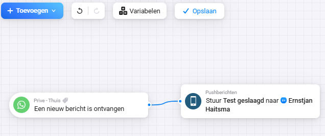

I have installed the app on homey, it works to send messages but i can not use it as a start for a flow. it just does not respond on an incomming message., what am i doing wrong?
@Ernstjan_Haitsma please send a diagnostic report
code: 9A55F2EC
@Ernstjan_Haitsma that’s for athom employees which I’m not
Please send via the app itself not the homey report
Now the right report: 56fa2462-871a-4d55-b272-244afd791fb2
@Ernstjan_Haitsma I don’t see an issue. Can you share the situation? Group app or direct message etc

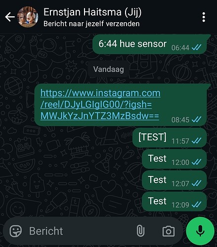

Hi Martijn,
I send those test messages but no response in homey
Beste regards,
Ernstjan
(attachments)
@Ernstjan_Haitsma ok but as I asked can you clarify the situation. Groups app, or a DM?
it is a DM from another phone to myself
@Ernstjan_Haitsma strange. Can you send that message again and after that send a new report?
i send a new message e8761b3f-53f0-4206-8e33-e0ab6fbb439e
i removed my whatsapp device and added it again, restarted the homey whatsapp app and now it works
@Ernstjan_Haitsma great that it works now!
