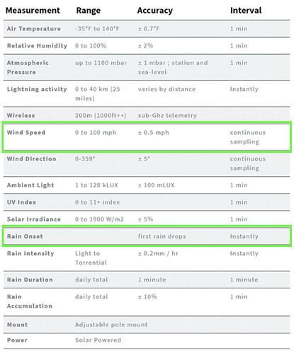

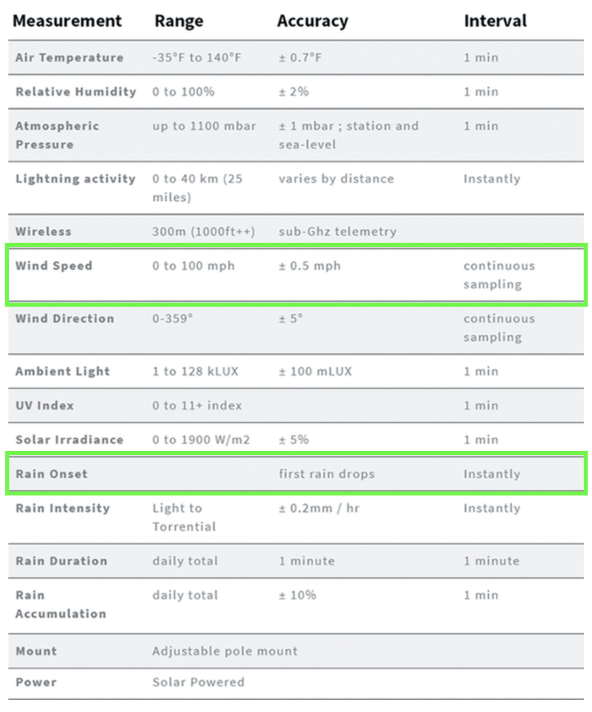

The following technical datas are written regarding the measurement resp. interval of the beginning of rain and wind in general:
Rain
As soon as the first raindrops are detected, it will be reported. After all, this is necessary so that the awning closes immediately.
There is also a card in the app for this: It starts raining.
Therefore, I do not understand the need of a variable. Maybe one of you could post the flow so I understand it better maybe.
Wind
In the FAQs the following is is explained about the wind measurement:
Every 3 seconds the ultrasonic transducers sample the wind speed and direction. These values are averaged in one-minute observations. The lull is the lowest of the 3-sec readings and the gust is the highest of the 3 sec readings. The one minute averages become part of your station’s long term record. These are World Meteorological Organization (WMO) standard sampling methods.
What does it mean exactly? At what interval the values are reported to Homey? Every 3 seconds, or only every minute?
They can write that but it doesn’t work like that. The ‘it starts raining’ indication takes way longer than that and only starts after more than a few drops. So, that’s why we create a variable. The variable registers rain much earlier than that indicator.
