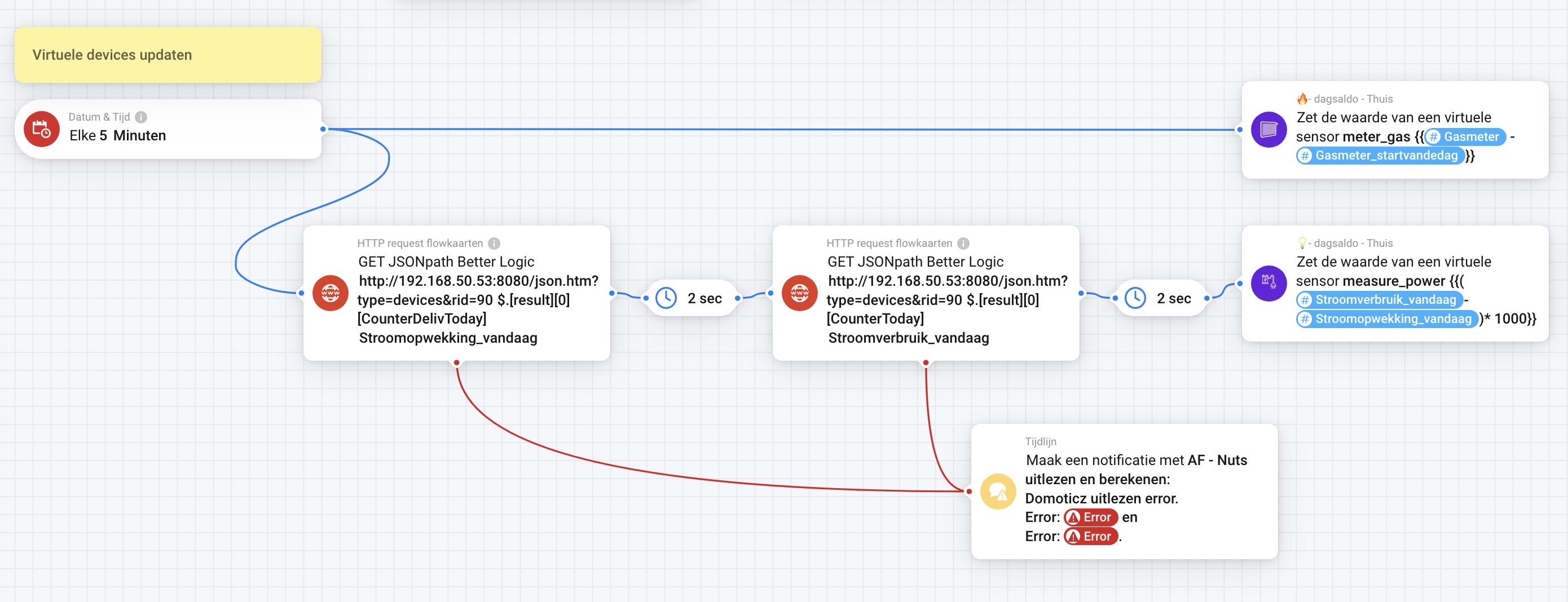

I use the App “Virtual device” and have made two devices that now show my Gas a Electricity consumption:
Schermafbeelding 2022-11-17 om 13.00.41
This is the advanced flow that updates the two devices:
I also have the App “Advanced Capabilities” installed. That would possible allow me to delete the first App and use this more sophisticated (and complex) App to update my two devices. I am stuck on how to do this. Any suggestions?

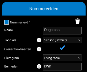

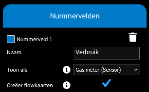

If you put it like this, you can have a custom icon in the sensor tab aswell:
Or round the decimals to 0 or not.
(dont forget to set the field as Status Indicator in the Homey App.)
