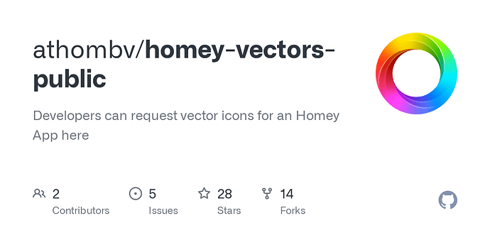

Here you can find lots of valid .svg icons, and view them.
