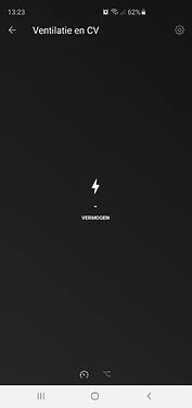

I have a power measure related question too:
My ventilation is switched by a Shelly relay. Since Shelly can not measure power used by the ventilation (power is drawn from a third powerline), I would like to use a virtual device for hving it shown up in Homey Energy.
(Since the Shelly has power metering capabilities, I cannot “overrule” this by manually entering values for on/off)
If I am correct, this should be possible from VD app v.0.9.0 onwards.
So what I did was:
Create a Virtual Device with (only) power measure capabilities.
Then I made the following flow to write the power value (I read that off my smart meter) to the virtual device when the ventilation was turned on.
Unfortunately, nothing is being written to the VD and the VD is not showing up in Homey Energy too…
What am I doing wrong?
Maybe it also needs the on/off capability?
Tried that, but no luck unfortunately
Set value=measure_power.
chrome_2021-01-01_14-56-20
Thx @Rocodamelshekima!
So, had to manually type in “measure_power” in the first field and a numeric value in the second.
(this might clearify it a bit more to other users)
I selected the power tag of the VD there.
