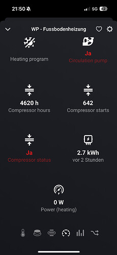

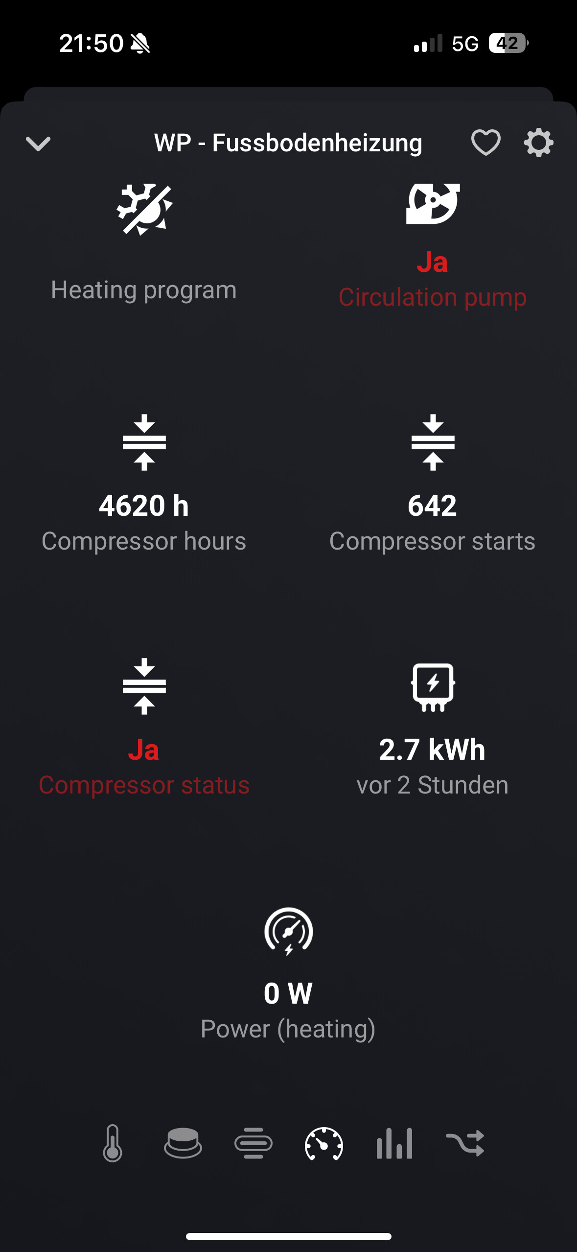

I’ve discoverd a bug in the power consumption for heating. The other power consumption values should work correctly though. v0.8.2 should fix it for the heating.
In which part of the flows is this? I don’t directly see where it is, so I can try to reproduce it and attempt to investigate/fix it.
In any advanced flow, we can put input values for any card and choose a tag. When I click on tag I can find my viessman device created by your plugin, it list all the tag but all values are empty.
I just checked the values and now for energy heating there’s a value. But it doesn’t change since new new version is installed. Seems like it grabbed the value when vissmann app got updated and stays stable now. Check in viessmann app and there changed continuously.
