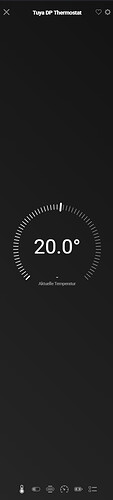

If I install the Tuya DP thermostat I can set the TARGET temp without an error message, but the temp is not transferred to the device.
However, no actual temperature is displayed. If other settings are made:

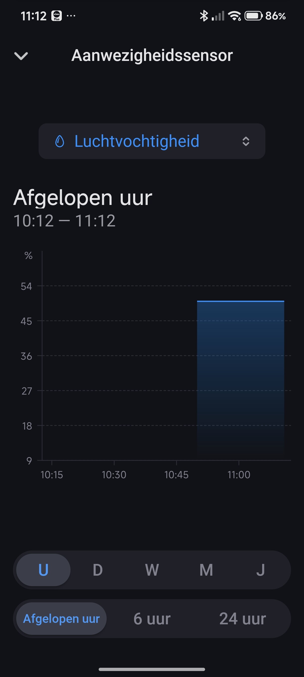

Hi @dlnraja
Thanks for all your work for this app, good to see that this app improves everyday.
For the presence sensor i still have the same issue, connected as unknown device.
Please let me know if you need a new interview or report.
Thanks JJ
