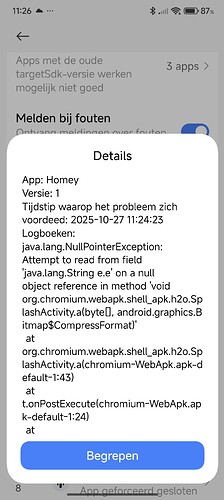

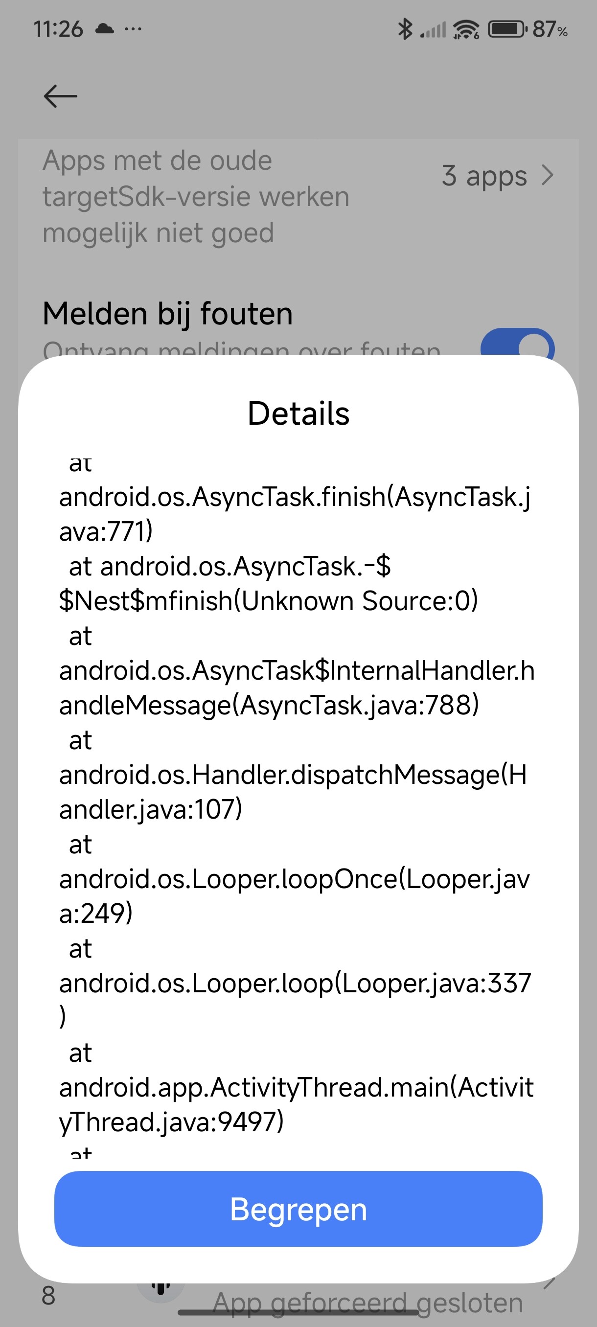

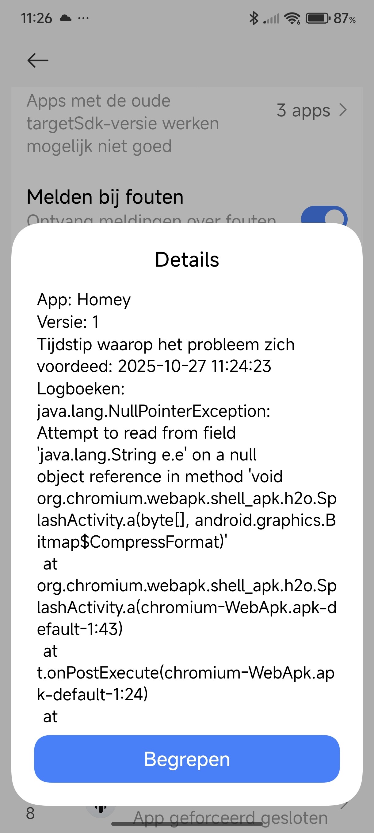

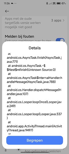

Yes I don’t receive any crash log, perhaps an homey issue .
