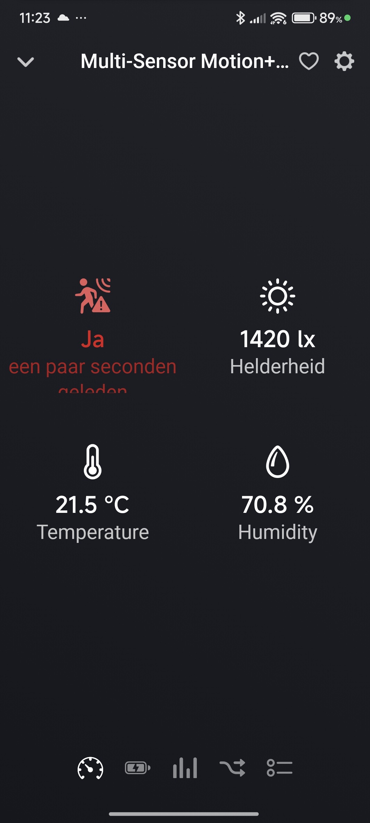

Hi Dylan you’re finally there with the Multisensor, Finally Motion sensor is working all the Data is correct. SOS button only battery reading is there, no response on pressing the button.

Thank you for the diagnostic report! I analyzed the logs and corrected the issues:
Motion sensor: :white_check_mark: Working perfectly! The battery error is just a non-critical log message—the battery data is working correctly via polling.
SOS button: :warning: The button is not responding due to an IAS Zone registration issue. I fixed the issue by adding several methods for retrieving the IEEE address.
