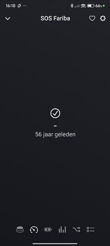

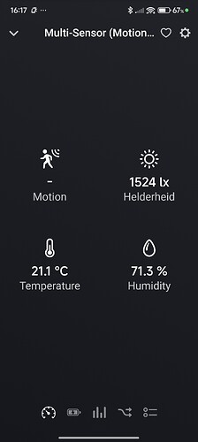

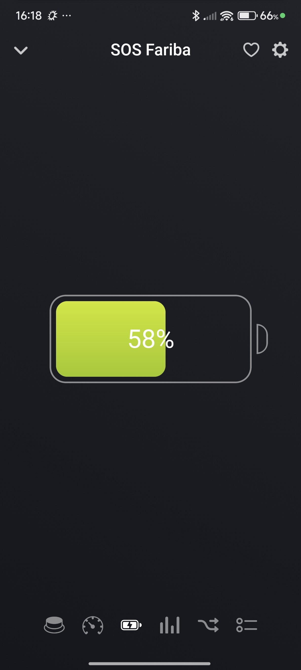

Hi Dylan you almost did it, Ver 3.1.17 installed. Multisensor is displaying data on Temp Hum & Luminance and Battery :battery: indicator also. Only no Motion triggering.
:sos_button: Button has battery :battery: indicator now but still no triggering on pressing the button.
Diagnostic code: 57b36f1e-76f5-4f75-a64e-5a616e6f5cdc
Keep up your good work you getting there at :folded_hands:t2::+1:t2:
Best regards Peter.

Hi Dylan, I’ve seen this morning that you uploaded a new version 3.1.21 after installing and testing still no progress on Motion detection and SOS :sos_button: Button not triggering.
Diagnostic code: 200a2ea9-fe54-4f97-966c-f44eb0c966c5
Thx and Good luck :pensive_face: :crossed_fingers:t2:
Best regards Peter.
