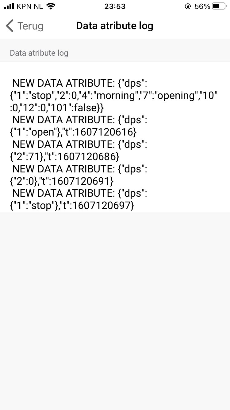

I bought a battery operated curtain motor set, and i know that battery operated Tuya devices are not supported by the app because normally they go to sleep…
But i thought let’s be clever and bought NOT the regular version. :sunglasses:
This is the set: Zemismart Tuya Smart Gordijn Driver Voor Romeinse I Type U Type Gordijnen Track Smart Leven Timer Alexa Google Home Control|Automatische Gordijn Control Systeem| - AliExpress
As you can see on the pictures it is a set with a remote based on handheld 433Mhz remote control.
Beside the remotes there is a USB based controller with 433 communication to the motors but with Wifi Tuya integration towards the Smart life App. And because the USB Wifi controlles is on continous power it stays always on !
I tested them and they operate fine.
Integrated them in your App as ANCCY curtain motor switch, and i can control them.
It is not working perfectly yet, every time i press the button the motor runs for one second instead of walking completely to the end of the rail in one run, but it is a good start i think :slight_smile:
This is the dataset i pulled from the app:
Can you integrate it in your app please ?
If i can help with more information or testing please don’t hesitate to let me know.
Thanks in advance Rens, and keep up the good work !
