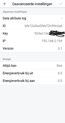

Hi Rens, did some extra testing…
so when homey is rebooting, you see the smartplugs working for some seconds (even indicating the power usage for a second)…
afterwards this is what is mentioned in the dps
NEW DATA ATRIBUTE: {β€œdps”:{β€œ1”:null,β€œ2”:null,β€œ3”:null,β€œ101”:null,β€œ102”:null,β€œ103”:null}}
the strange thing is that if I use the β€œweb app” (browserversion)
with the standard view it’s indicated it’s unavailable (and can’t operate it)
but if I change the view to big items (or whatever it’s called), I can use the slider to turn the device on/off…
maybe this helps to troubleshoot?
kind regards

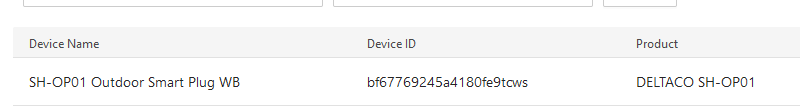

I have same problem I think. This device has worked for a couple of weeks then suddenly it stopped working. Looking in logs gives the same response as above NEW DATA ATRIBUTE: {β€œdps”:{β€œ1”:null,β€œ2”:null,β€œ3”:null,β€œ101”:null,β€œ102”:null,β€œ103”:null}}.
I have now tried and re-add the device, and everything seems to be right except I cannot control the device. Device works through SmartLife app. The device is an Deltaco outdoor plug with powermeetering.
