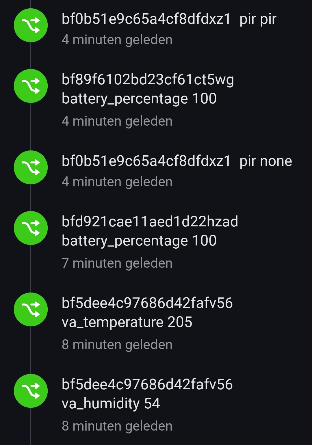

I have added a Zigbee Tuya sensor via Tuya cloud to Homey and did not set any card for that to get info but I get every few minutes all kind of unwanted info from the sensor in my Homey timeline.
No idea why because there is no automation set in Tuya and not in Homey.
