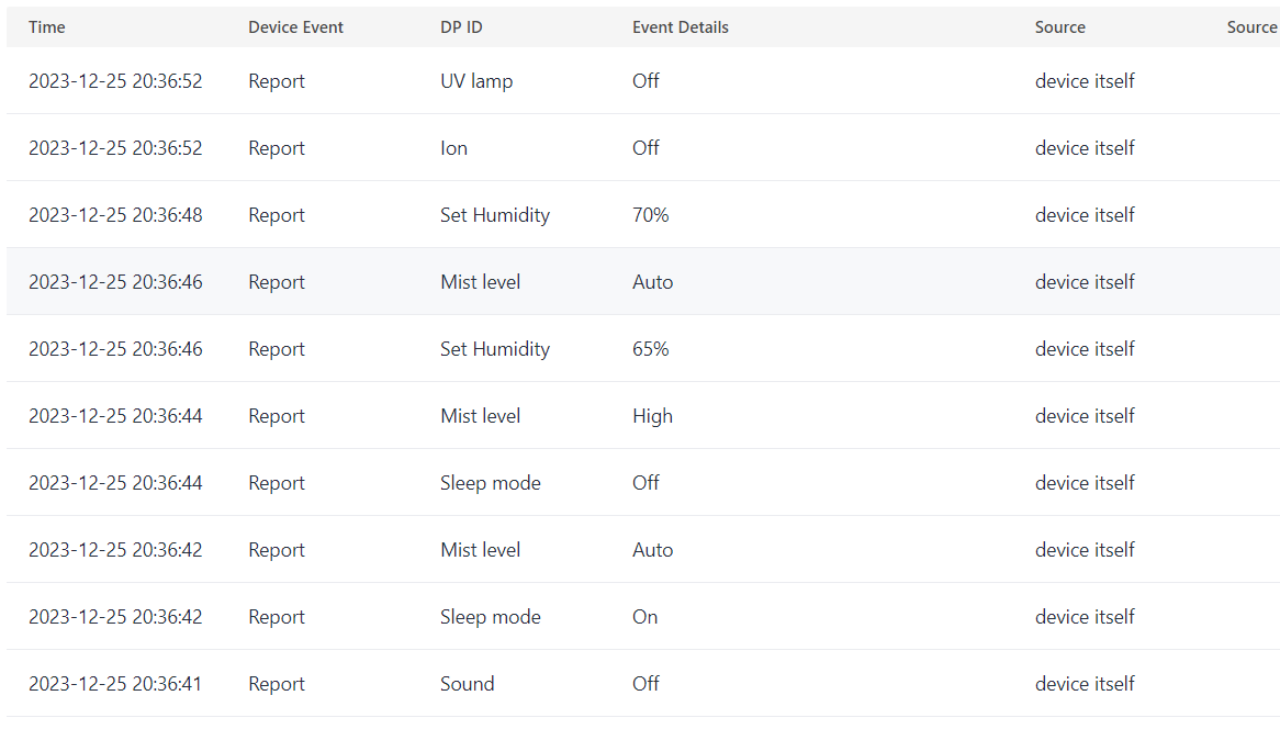

I was able to connect the (updated) Tuya Homey app to my Tuya iot account.
I see my humidifier in my Tuya iot account online as well.
But when I try to add the device in Homey, it says there are no new devices found. I tried the “dehumidifier” category at first of course, but the other categories give the same message.
I found the following in my Tuya iot account, so I suppose a humidifier is another category?
If so, would you be willing to help in adding this to your repository, @Jepke, so (hopefully) @Jurgen_Heine is willing to merge it in the app?

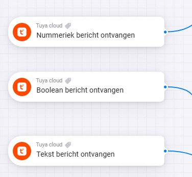

I did manage to receive the messages from Tuya with the flow cards.
flow cards

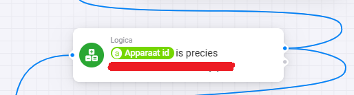

And use the Lociga with device ID, i can get the inforrmation in variables as well.
flow2
But unfurtunally Tuya Cloud is not sending all relevant information.

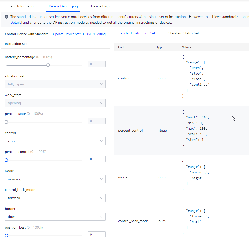

jsq category is not there yet. If it has the same controls as either the airpurifier or dehumidifier its an easy add.
Login to the tuya cloud developer portal and look for device debug features. Below screenshot are a few of what my dehumidifier has.
I can send you, if you would be willing…
Can you make something then that Jurgen can add easily?
You mean to add “jsq” to the airConditioner category?
I can only see the instructions like open/close and that doesn’t really fit to thermostats
If the state has a current/targettemperature, it could work. But if it has no target temperature but only open/close state I think it won’t work.
