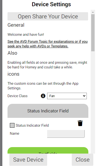

Hi! I’m trying to copy this, but not really sure how to set the AVD. Do you have screenshots of your AVD? Thanks!
where are you unsure?
Thank you! I’m not that familiar yet with AVD and I see I was missing some check-boxes. The forward and reverse, is that a text button or…?
ik was een plaatje vergeten, voeg het toe aan post hierboven
