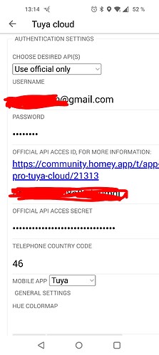

Hi, Im trying to configure Tuya Cloud app but got stucked. What am i doing wrong? Cant delete the link in the “api field”. Maybe thats the problem? followed allt the steps in the guide.

That link is ofc not inside the API field, but above it :wink:
