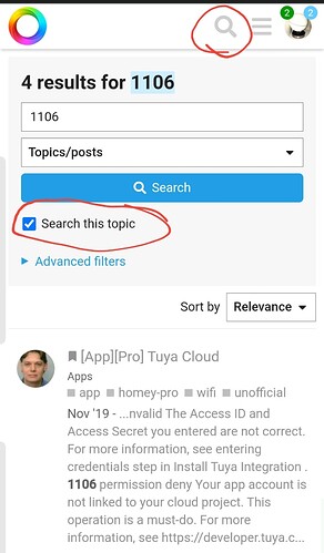

The search function works very well :wink:

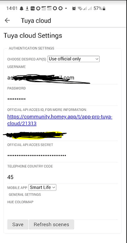

Show your TC app config screen (with personal data blurred) please

No I was dead serious this time :wink: :grinning:. As you can see at the screenshot I added, the first result is already the post with the possible solutions.
And these questions about those error codes were asked and answered here many times already :hugs:
Can you show please which search phrase does not work in your case? Maybe we can find what’s not working for you.

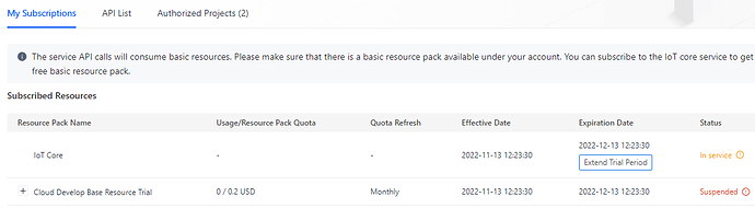

There are 2 possible problems. Wrong configuration or skipping one of the steps when first time new API is used. Besides misconfiguration there is of course the expiring trial which has to be renewed. If it did work correctly before with new API, it’s mostly expired services. If a device is not found, it’s possible not supported yet. Tuya uses device categories, and some device types have multiple categories and Tuya is adding new categories. This means for example that lights are supported with many categories, but if there is an new one, this one is not supported unless it is added. Also getting no error on settings page doesn’t mean you have configured everything correctly. It only means that this app can communicate successfully with the API. But you still can have errors, when operating a devices, if the Tuya IOT platform is not setup correctly.
That looks OK to me.
(App removal and such is not of any use I think.)
Datacenter = Central Europe (45 Danmark )?
All services are not to be renewed?
Renewal was crazy expensive
You can renew the trial as described in post 1
But I guess you only can extend it once?
Huh, finally found a button to click:
Didnt realize I had to click the ‘View details’.
The extension has now been applied for (6 months). It is under review…?
Data center is central europe.
