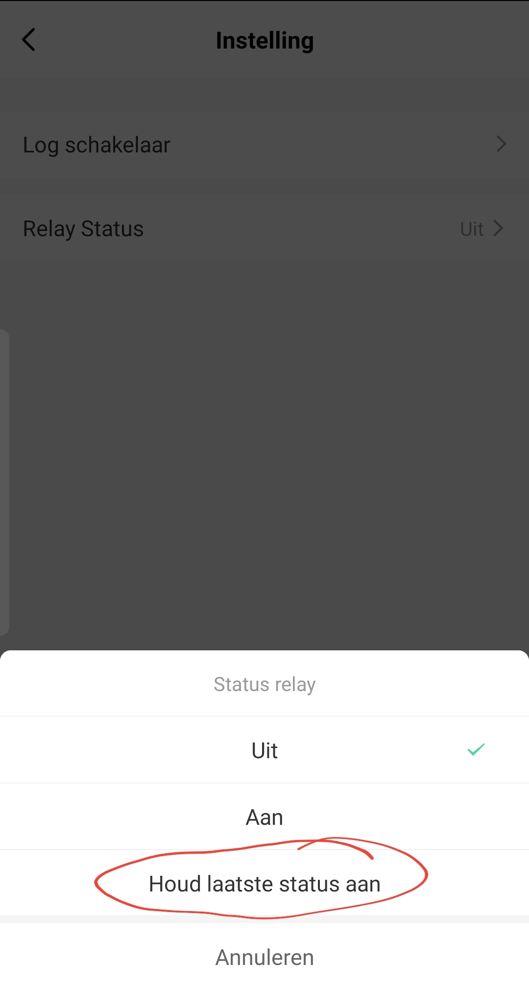

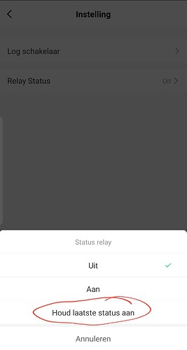

After power outage:
Uit = Off
Aan = On
Houd laatste status aan = revert to last state
New version is on test with fix from @RonnyW for thermostat :+1: Delete the thermostat first and add it again.

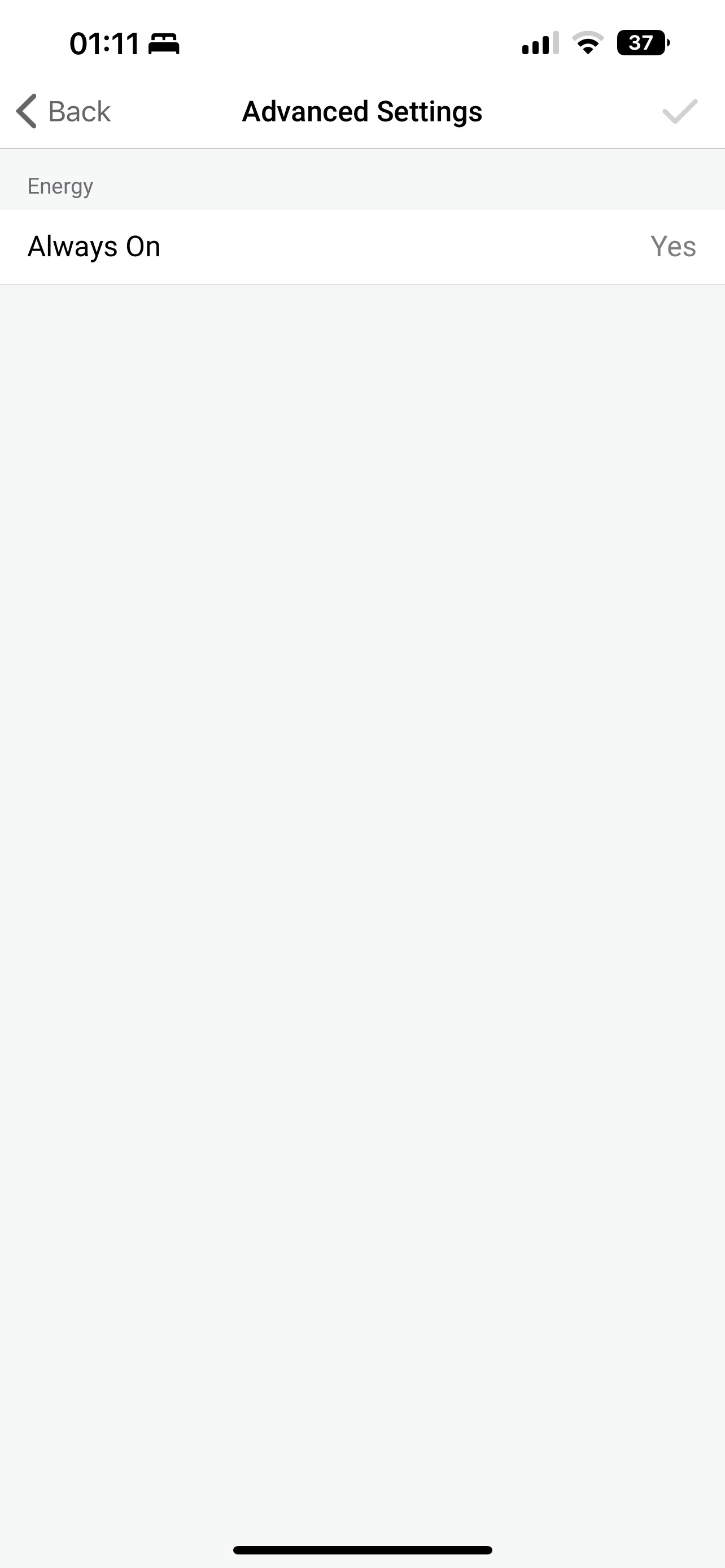

I don’t mean ‘power on after power loss’
I mean lock the device button from beeing able to turn the socket off.
The sockets are used to measure energy and connected to different hardware like my freezers, servers, computers and more. If I accidentrly touch the device icon in Homey my servers will loose power. This is what I want to prevent.
The SH-OP01 socket has this settings under Advanced Settings in the Device in Homey.

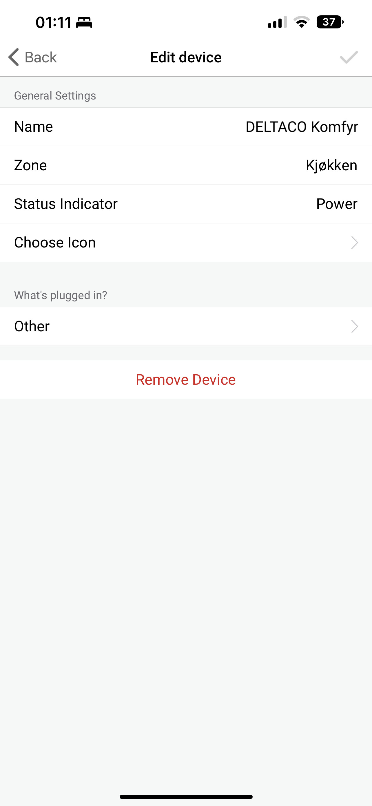

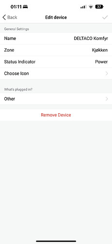

The SH-P02E socket does NOT have the Advanced menu.
SH-OP01:
Advanced Menu:
SH-P02E:
