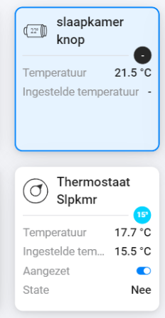

hi there
I have a problem.
the communication between homey and the tuya radiator knob,
if i change temprature in homey in the radiator knob itself it changes in tuya app too.
also when i change the virtual thermostat it changes in the tuya app. only then will it not be passed on to the homey variant. even when I adjust it in the tuya app, nothing happens in the homey…

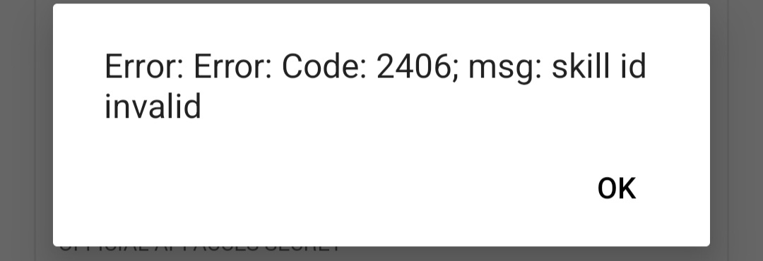

The app just stopped working for me, already added devices dont respond. And if i try to add a new device it says “please configure app first”. IF I go into config this is what i see when i press save.
Tried both stable and test version

@Wondah, you can complain here, but you should complain by Tuya. It’s not my choice on how it should work, but it’s the way Tuya wants. It’s better then not able to connect at all. Together with other community members we try to get users to connect their Tuya devices to Homey.
@DjTail It’s literal couple post above…

got the new version of the app.
and reconnected the thermostat to the tuya app and re-added it to the tuya cloud but made no difference.
if I change the temperature in the cloud app, it also changes in the tiua app,
When I change the flow temperature, nothing happens.
and if I change the temperature in the tuya app, nothing happens in the homey cloud app either

I just did that
tuya app listens to tuya homey(when i change something in the homey tuya it also changes in my phone tuya app)
tuya homey does not listen to the tuya app (when something changes in the tuya phone app, nothing happens in homey)
and the tuya app and tuya homey don’t listen to the advanced flow
Did you select all the services as mentioned in post 1. It sounds like you forgot Device Status Notification…
this is wat i do/get

I also re-linked my account again, and reset the thermostat to factory settings and paired it again. without success the same story as below the problem remains
