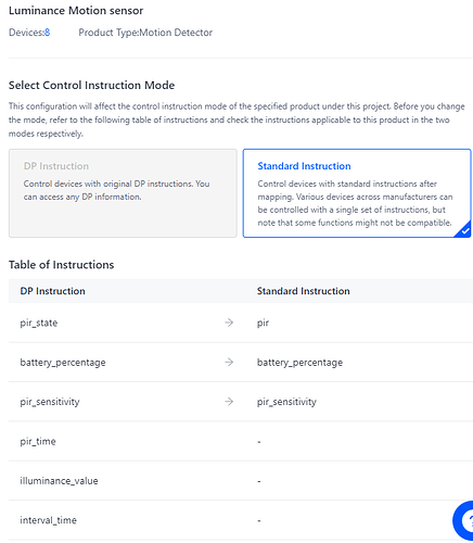

This is also totally new to me. Now I do understand why my Luminance Motion Sensors never report(ed) any illuminance_value. Switching to DP instruction (for whatever that might mean) solves it.
Thank you @Yankee_Delta for these insights!

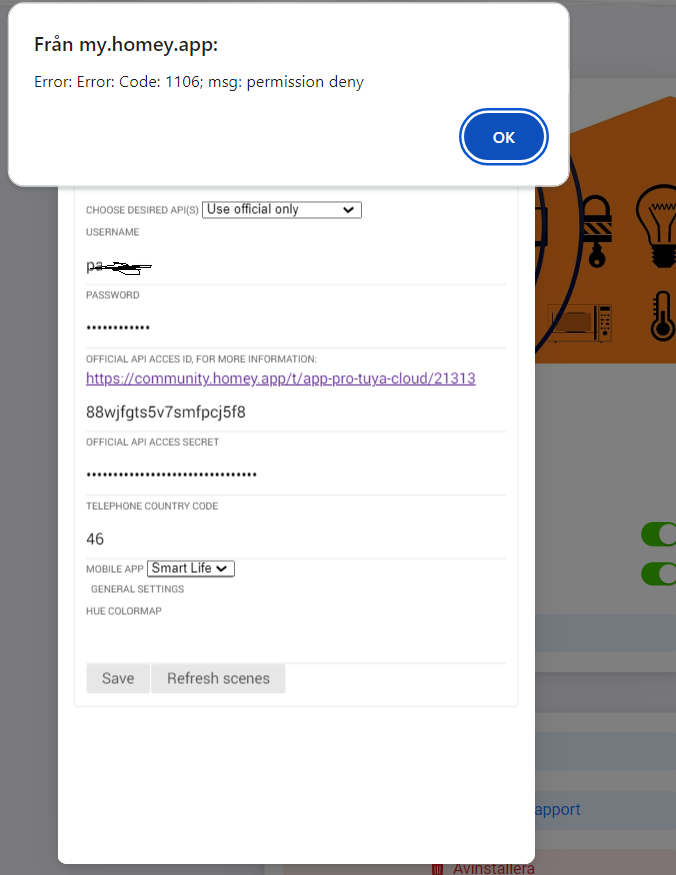

I get error message when trying to connect.

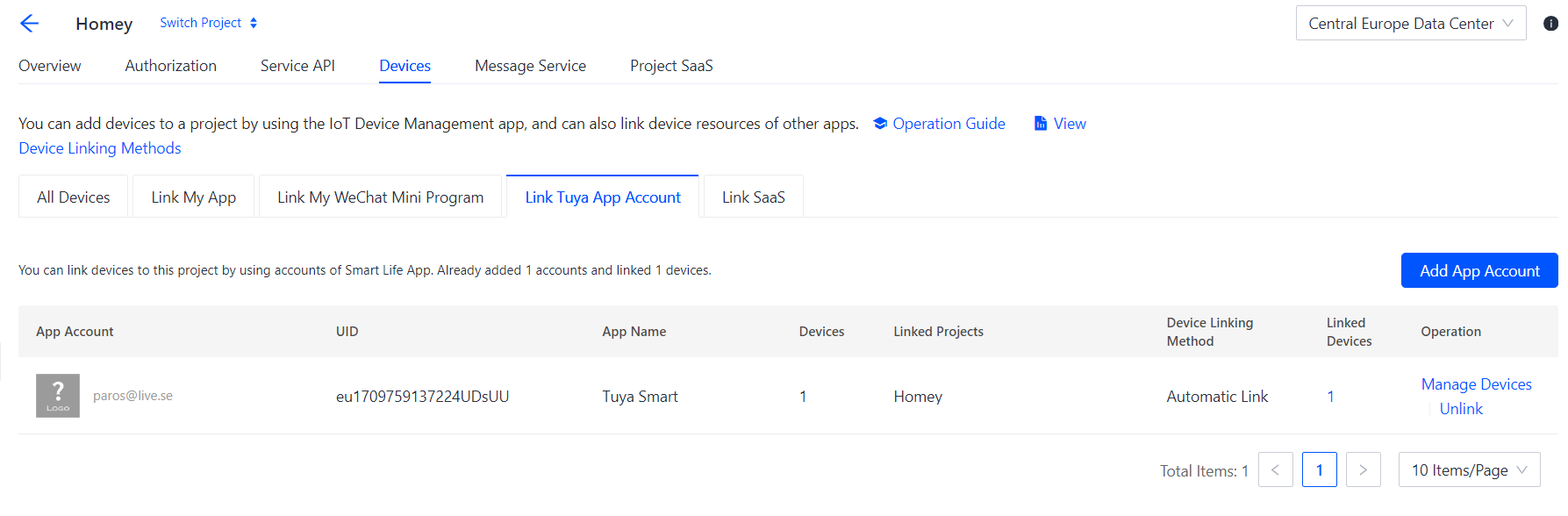

I am using Tuya smart app (the motion sensor is working fine in the app) and everything seems to be set up correct. What have I missed?
I am using same username/password for developer and in the Tuya smart app.
The Tuya smart app username should be your registered (home owner) email address, not literally the username from that app.
Look @ the example screenshot pls.:
Also, in the 1st post you’ll find some error numbers and possible fixes.

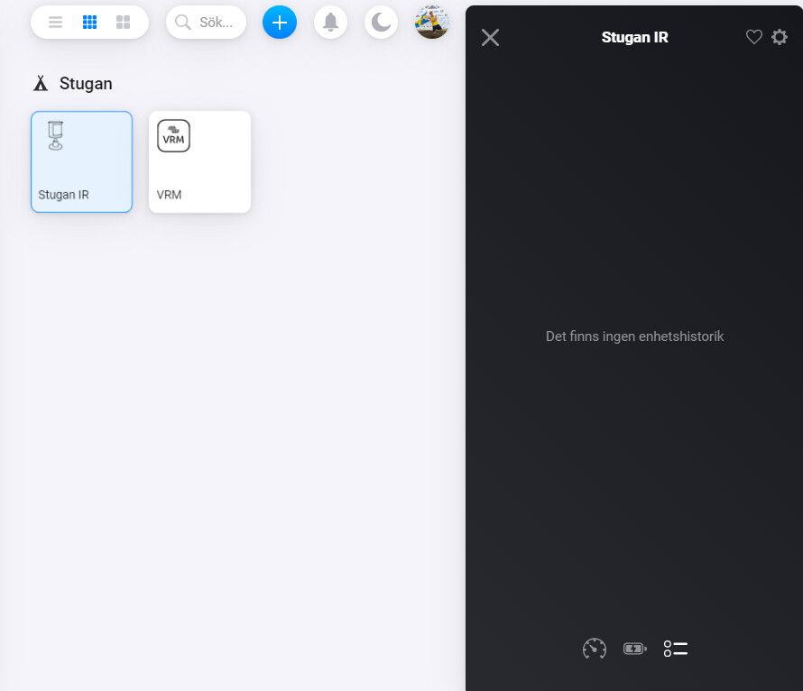

I created new accounts and I can finish the configuration in Homey app and add the a new Tuya device (motions sensor).
However, when I trigger the motionsensor, I get a notification in the Tuya mobile app and the log in the developer interface is updated, but the motion sensor in Homey is not updated?

I masked my email (I used a emailadress as username). However, i created new accounts and now I get the motionsensor in Homey.
But, when motion is triggered; nothing happens in Homey (but I can see events in Tuya IOT platform). See pictures in previous post.
