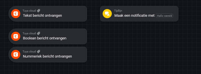

So like this? caus thats the only then card whit timeline i can use.
Sorry mabby newbe question :confused:
If you connect your boolean When card to a Then card, you will be able to use the tags provided by the When card.

so just conect the to and make hello world to a tag i chose?
the rest i`m kind of formiliar i just dont know how that is going to give me the text.
afbeelding
You could even do this in a normal flow. Still have to test it though
like i thought i miss somthing…
afbeelding

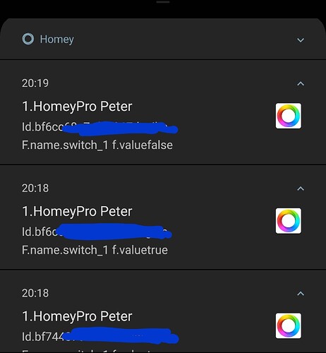

Here’s a screenvid:
GIF_20240227_202537_412
Push messages after I turned some Tuya lights on/off:

I have created the flow that I pointed out. Still after I control some of my Tuya stuff, it doesn’t send any push messages
Then something seems to be in error… Does “execute a scene” (which was made in the phone app) still work?
Or, your push messages are rate limited, this is only to discover when you test run the flow. The push card will then return an error.
To be sure it’s not the trigger, just add an other notification card, like Simple Log
did like you told me but its not giving a nonification :confused:
any idee how to check where it went wrong?
