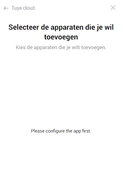

If i try to add a new device in Tuya Cloud i get the following message:
Is there anyone that can help me out with this?

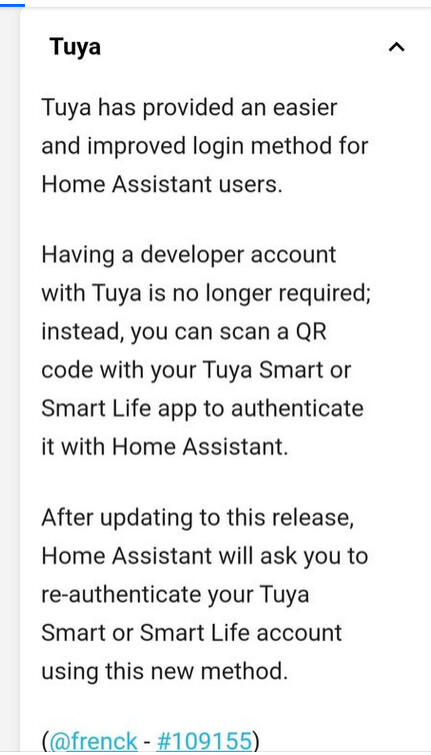

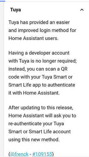

It seems Tuya changed the way to login and you do not need no longer the developer api, HomeAssistant has already updated there integration, I hope the homey app will also be updated soon…
That’s very good news, B3rt.
I hope it’s possible to update this Tuya Cloud app by creating a Pull Request.
I can confirm the new API works, and connecting with it @ HomeAssistant was a blast.
https://github.com/tuya/tuya-device-sharing-sdk/
Here’s the changes from the HA Tuya integration for anyone interested:
https://github.com/home-assistant/core/pull/109155

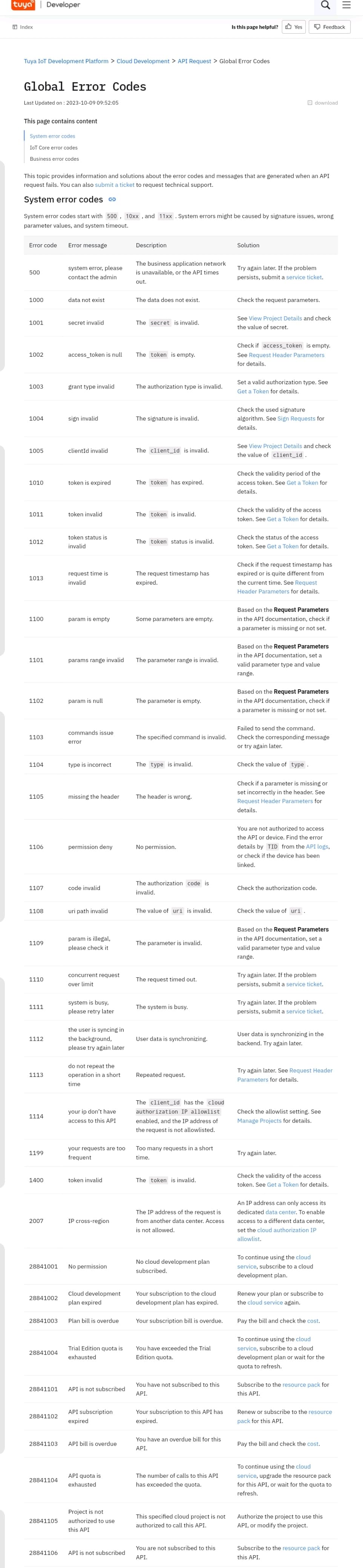

Hello everyone,
Since i had some issues with some of my Tuya lights. After restarting the app everything of Tuya has stopped working.
After some research i had to extend the trail version. Its already 2 hours later after they accepted the new trail period.
I also tried to update the Tuya settings in Homey to check if everything is oke, but if i try to save the setting i get this error code showing up.
Schermafbeelding 2024-02-11 135405
I dont know what i’ve done wrong.

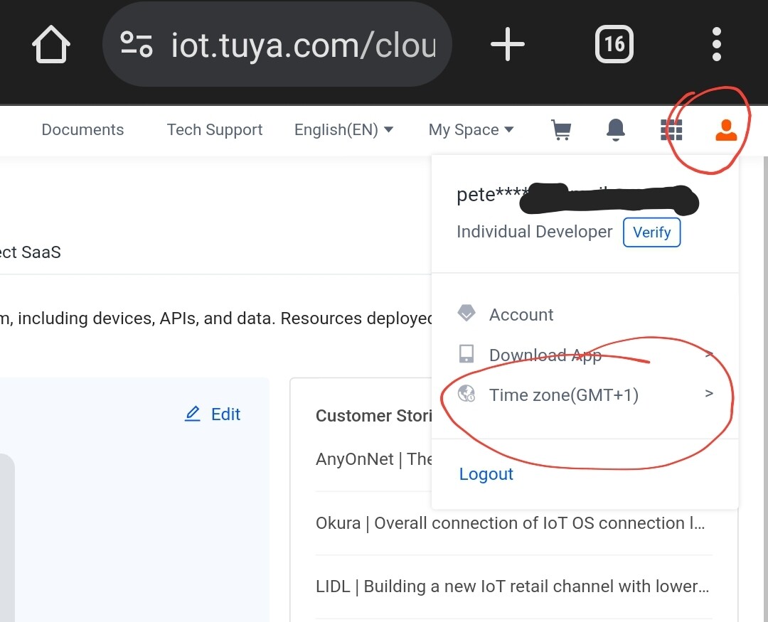

  • Is your Homey’s clock set correctly?
  • Have you set the correct timezone with TuYa?
Yup,
All error codes + possible fixes found with a search engine:
The Time of Homey was about 20 minutes off the real time.
I restarted the Homey and the time is now correct.
The only thing i dont can find the settings of the timezone of Tuya. The location is set on The Netherlands, so thats correct. Dont know if that automatic the timezone.
It’s @ account:
