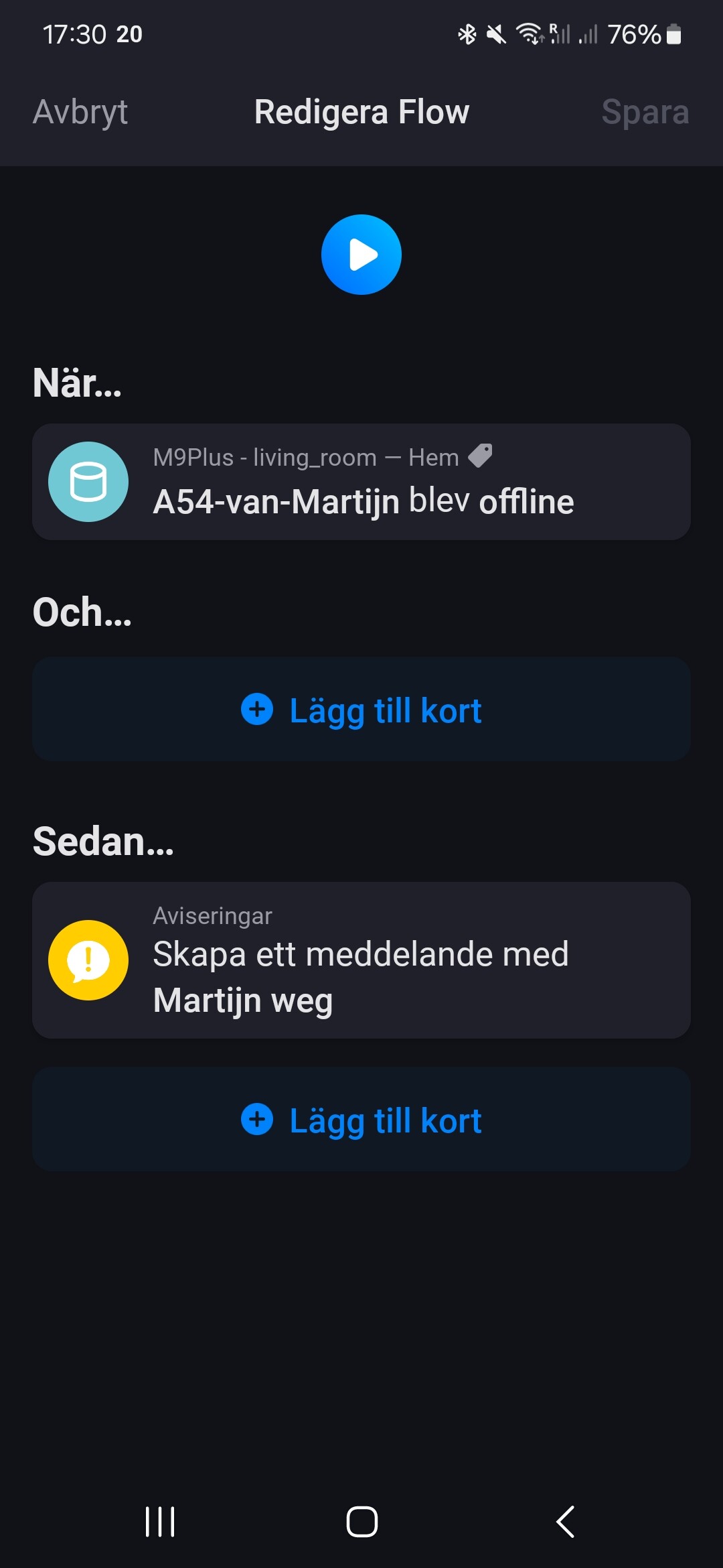

After the update i tested presence.
Its working fine when i leave home then i get a message.
But when I’m home i get a offline and online message every minute.
Is this something i do fail or can adjust ?
My device is connected with the same deco so its not changing between decos.
Thanks for a reply and all the time and effort you put in the app ! ![]()
Thanks. Could you share your flow so could test the setup
A screenshot or what do you mean ?
Yes a screenshot
Hi
Could you see something on my flow?
Hope i did everything correct.

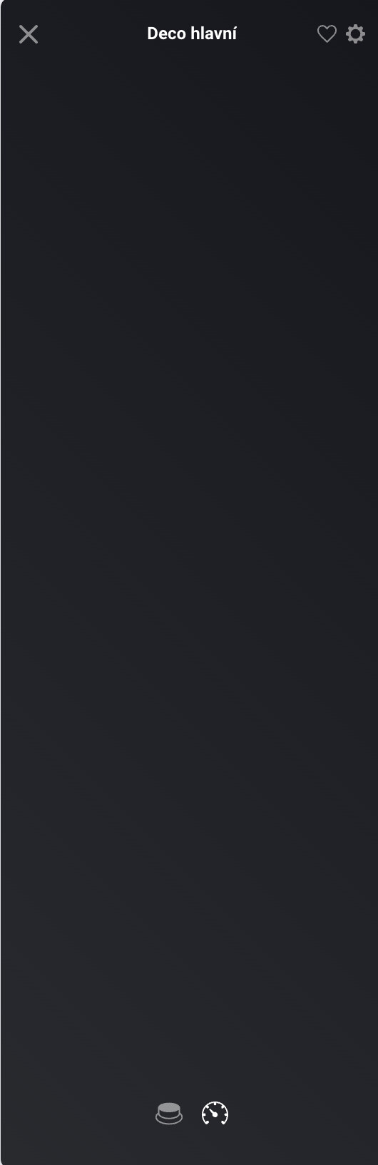

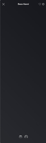

Hi, I am having some issues on PX50 routers… Probably after last update I lost all data in UI

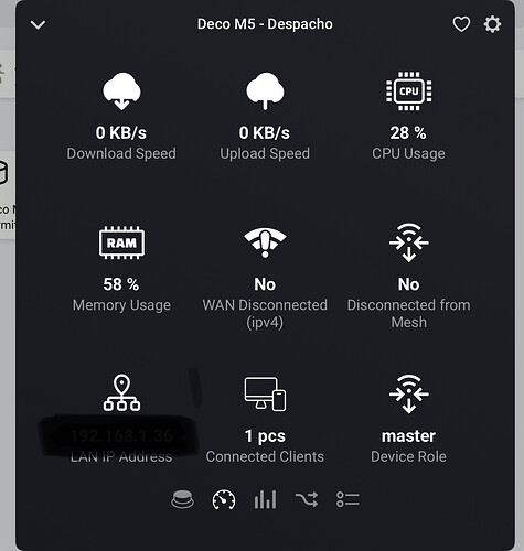

Hi, I am new to the communtiy and the Homey environment. So far, a very positive experience coming from Fibaro HC3. So hello and thank you in advance for your help.
I installed the application and it looks wonderful. Great job. Everything worked as explained. However, I am having some issues with my Deco M5 devices. I have 4 at home. They are all properly recognized and the app retrieves data from them but, download/upload speeds and connected clients do not retrieve data and are not updated.
Any guidance on this. I reviewed all the messages and saw some problems with M5’s but nos this one.
Find a screenshot of my master device (It has 25 clients connected according to the TpLink portal).
Thanks for your help.
re-install and re-add devices helped… ![]()
