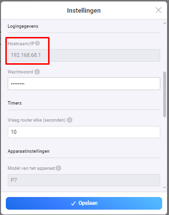

When I do indeed remove it and add it again, I see the following:
The best thing would be if I could change the ip address there
I changed it to be a text box instead of a label. You can install this version: TP-Link Deco App for Homey | Homey
Still, something is wrong with the driver’s init() when you add the devices, as it should give you the device’s IP.
Thank you so much for taking a look and making an adjustment.
I have installed your version. I can now indeed change the ip address there and that works.

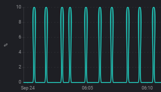

Something keeps taking more and more CPU-time, not more often as I assumed before), visible in last hour (10% takes bigger share…):
