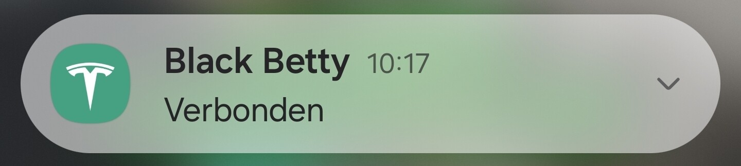

You mean like this?
Because, yes, I do have a bunch of phones and tablets connected almost all the time. Not all of them as phone key though. Some are like my daughter’s phone: she can interact with the car, but cannot start driving the car. That’s two different things, right? Being “connected” or “act as phone key”. Because at the same time, it states this:
Hm, don’t know in detail. I think it’s enough to be connected via BLE. If the app is installed and running, It can connect with BLE to open the door. Then it depends on being registered as key to really open the door. But the BLE connection should be established in this case. So yes, this can be a reason.

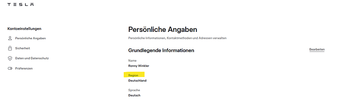

About region and regional API url…
I checked the API. The reqional URL and region is given by the API/Tesla based on the user settings. So I think it’s based on the account your are using for adding the device (not the developer account if you are using a second account for).
I don’t know if it’s easily changable (or only manipulating the HTML code in developer console). Perhaps it’s based on the address.
This region should match the region where your device is located.
