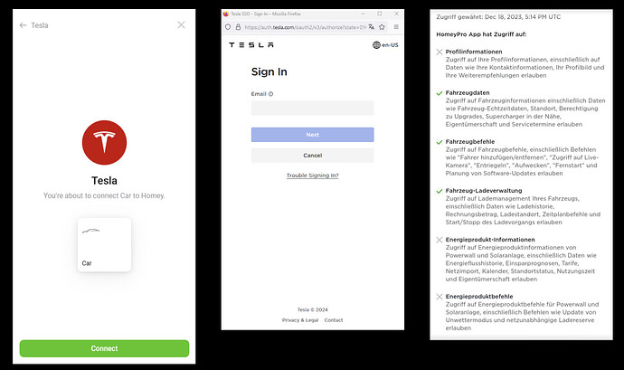

After using this great app (thanks!) for about one month, an exclamation mark suddenly appeared in the ‘car’ device. I tried every option available to repair, but it stopt after logging in on my Tesla account, showing a page ‘login with your account. Login on the website of the producer’ (I also tried to login to my Tesla account, opened the Tesla app, etc.). After this steps:
the proces stops and the attached attached screenshot is shown for a while.
The car device was not repaired.
I tried to remove the car device and add again. Without success (same page with same message as above was shown). Finally I removed ‘everything’: Tesla Homey App, Homey credentials in my Tesla account, keys in my Tesla and also restarted Homey to start all over again.
It ended at the same screen (screenshot).

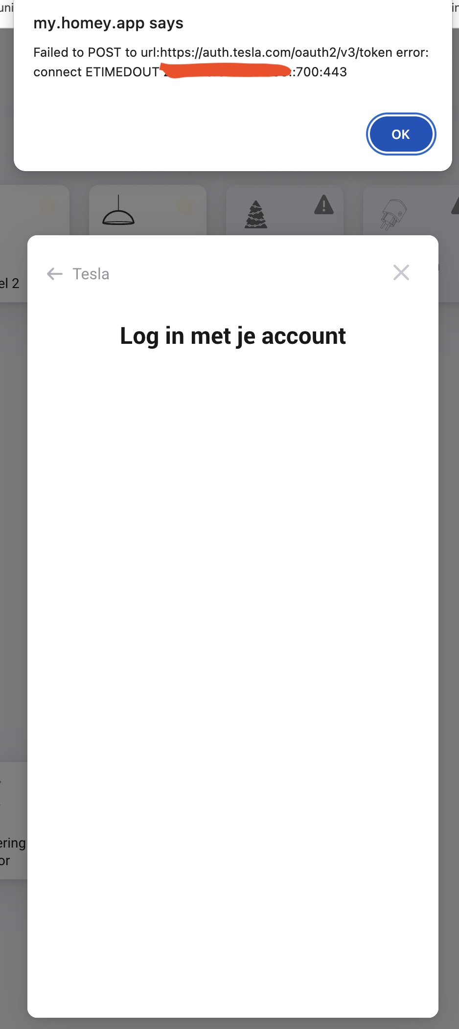

After a while an error (timeout) was shown (see second screenshot).
(I don’t know what the code ater ‘TIMEOUT’ means, so just in case I hide it behind a red line).
Access for the Homey app was granted again, I could see in my Tesla account. But whatever I tried, the process always stops when after the screen in first screenshot was shown for a while (ending in a time out error).
