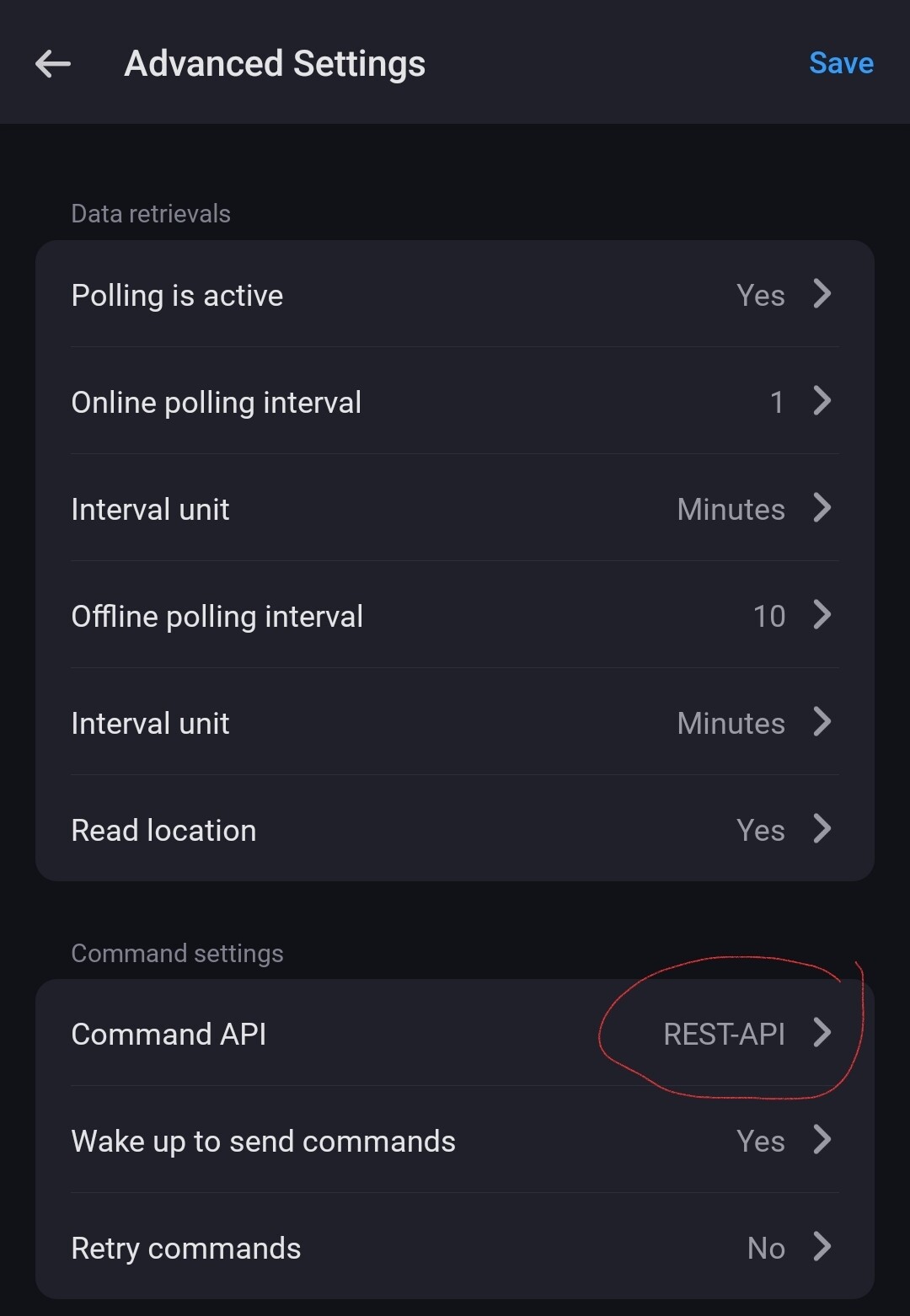

I’m not able to add the app as a key. Is it only possible for newer cars? I’ve a legacy model S (2017).
I reach the point where i can SEt Up Thirt-Partty Virtual Key, but when i tap “Finish Setup” nothing happens… I’m logged in on my account and Tesla App is installed.
Any idea?
Thank you
Angelo

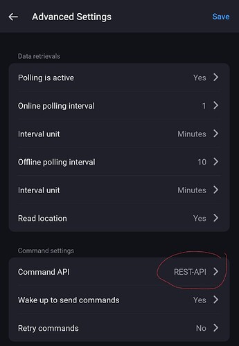

Hi, yes. that could be a reason. Then your car should still support the API without the car registration.
Please select the “REST API” in your car device settings as command API. That’s the legacy API for the older S/X models.

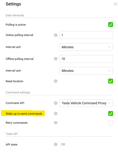

OK thanks. Is there something more to do after switch to rest-api? i still cannot send commands, but i receive data from the car…
API-Status is “OK” in the app.
Please check if you activated this option:
It wakes up the car is it’s sleeping - makes using flows easier.
Else you have to wake up manually vie car device or flow.
That would be the option I can imagign prerventing you to send commands.

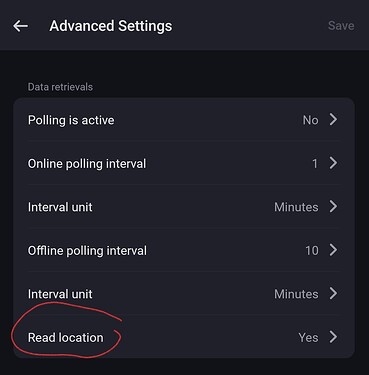

I’ve an issue with the location for my Model Y Performance. Only the first and the last icon will be updated. Any ideas how to fix this?
App Version v1.4.1
location reading is an opt-in for privacy reason.
You can activate it in car device settings.
Perfect, thanks a lot. To be honest, I didn‘t expect that option to be in the main car settings. I was searching in the „location“ app settings, …
Btw. I really appreciate your effort for the app. Thanks!
The car device is the “gateway” that’s handling the API and all connections. The other devices are just “outsourced” parts of car date to get a better handling for data/flows.
The location option is part of the API access, so I placed it next to the API settings.
But thinking about this…perhaps it would be also a good alternative to read location data if a location device is added - and use this device as opt-in.
Reason for this option is, that reading the location causes the privacy alert icon to be shown on the car display. That’s why it’s optional.

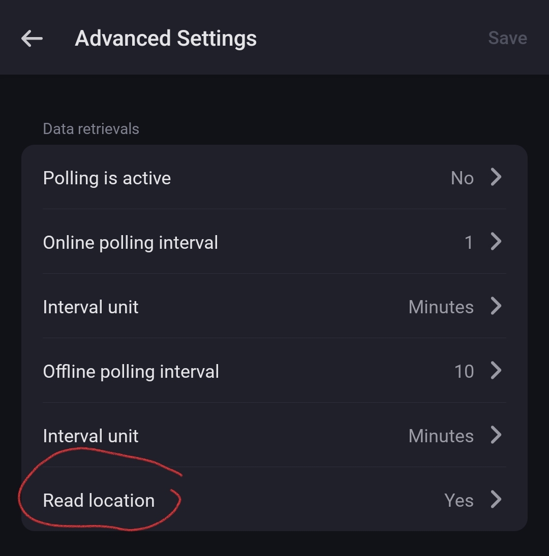

I fully get your point and I was aware that the “car” is the main app which deals with the API. Just that you understand me as user, here my thoughts which finally lead to this thread ;-):
  1. I didn’t expect that there is a global setting for enabling location settings
  2. Based on assumption 1, I checked the location settings. I would have been checked the main app if nothing would have been worked in the location app, but two icon were there with data. So I’ve restarted the registering process of the app but with (obviously) the same result.
I welcome feedback to improve usage :+1:
You are right. The technical reason is, that the data is passed to the location device (which is updating the timestamp), but it doesn’t set location data because it’s not included in the API response.
I’ll check if I can improve this process.
