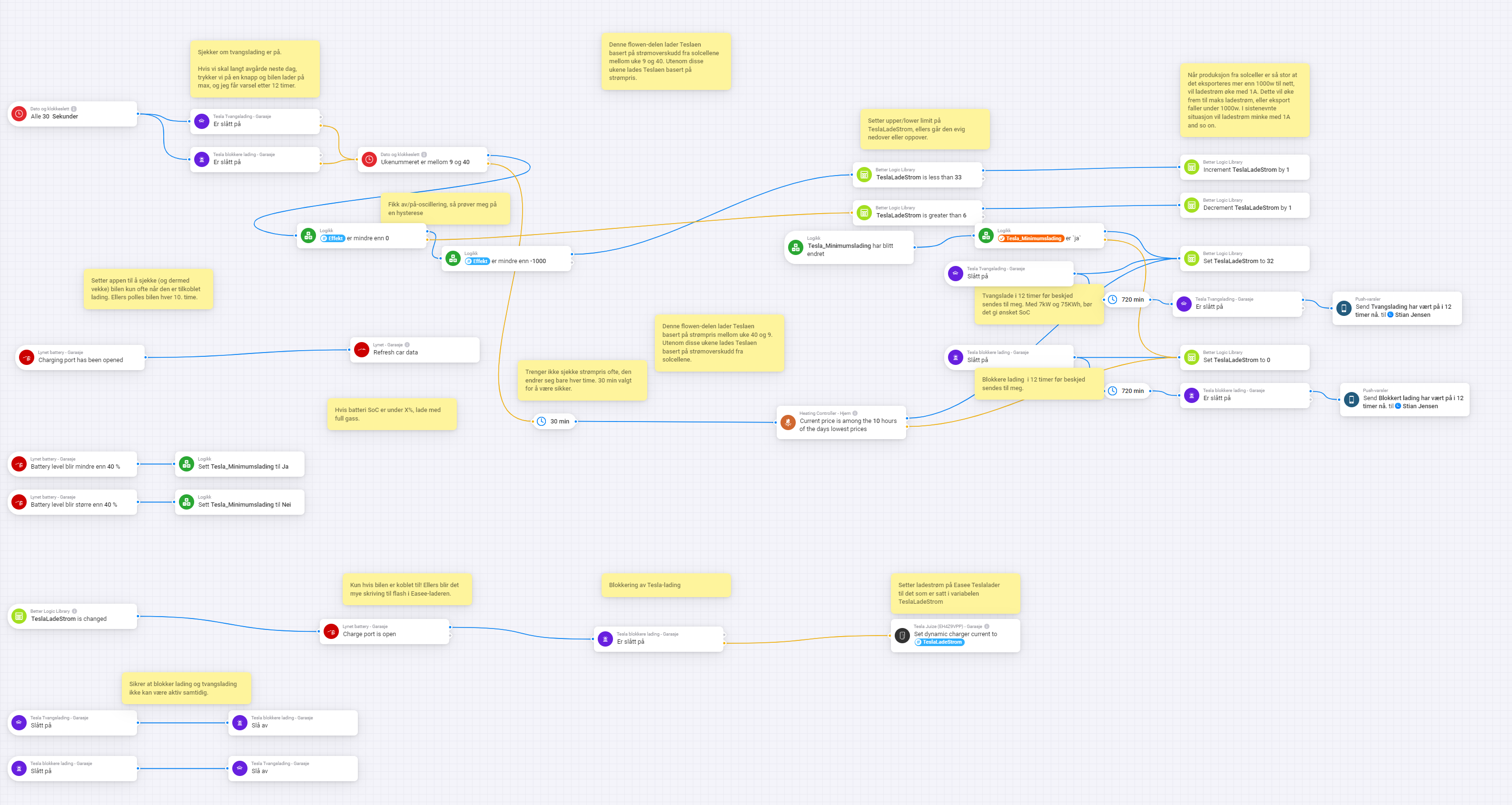

Some ideas about your flow…
I think this is causing your issue;
If the car goes to sleep while the charge port is open, the capability won’t change. And if you change the variable timebased, this flow will run to the wallbox settings. And if you activate the wallbox (start charging), the car wakes up and starts charging.

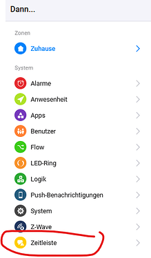

Add a timeline entry to check when and how often this happens.
And this is not needed:
grafik
The capability can only change if new data is received. That means: a data refresh is changing the capability, so you don’t need a manual refresh.
Thanks a lot for personal support! I will try your tips, once I find out how to add a timeline entry :wink:

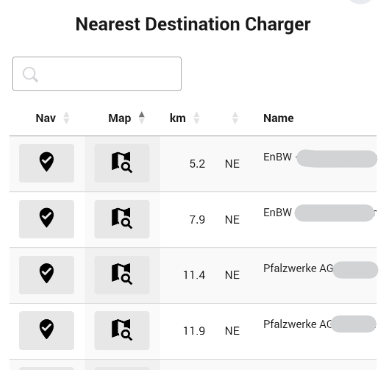

  • The location device has a manintenace view now.
    You can access a list all nearest SuCs and a list of nearest destination chargers.
    The view needs an awake car to get the data via API.
    You can start navigation directly from the list (1st button) or you can show the charger in GoogleMaps (coordinates from the API are used, so perhaps less accurate).
