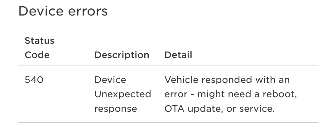

Anyone experiencing an 540 error when using a Flow card to turn on the Steering Wheel heating?
I have a 2021 S and other Climate cards (seat, temp) do work as expected.

I tried with a 2023 MY. C/A (preconditioning) must be on to be able to set steering wheel mode. If C/A is off, an error is thrown:
grafik
But perhaps the older car doesn’t support auto mode and levels.
In this case, another API request is needed I think. I can add this simple on/off next days.
