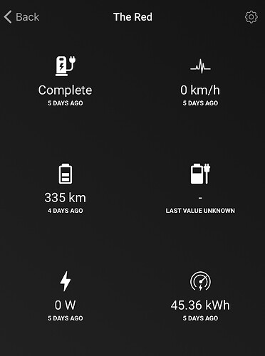

Hello, I am running version 1.2.10. I can add my Tesla but after a day it stops fetching the information completely and it stops taking commands from the app!
Any clue?
Can you click the “Create diagnostics report” - button in app settings, and I might see what’s wrong.
Tesla has changed the backend services (again), that led to timeouts when logging in. (<= v.1.2.10).
That has been fixed in v. 1.2.11:
