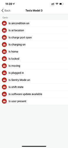

Couldn’t see any such options for conditions? And please don’t rule out the possibility that I’ve misunderstood :slight_smile:

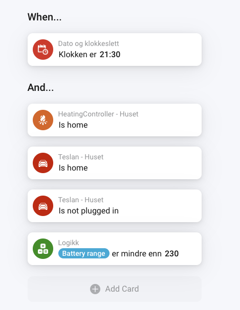

Use a logic card, e.g:
Skjermbilde 2021-03-25 kl. 11.44.04
If you need the value to be “fresh”, use a condition from the Tesla app before the logic condition. The condition will update the value of the token:

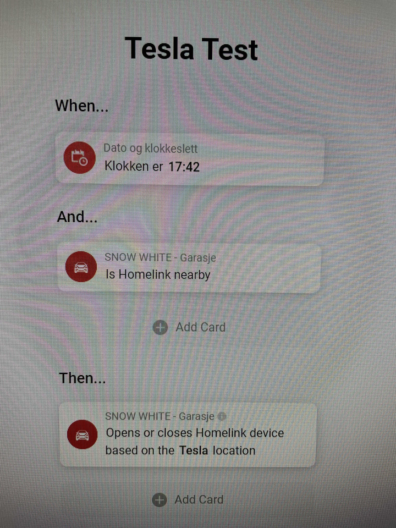

I’ve now conducted a test with the following flow and can confirm that it worked as expected. To wifeys great surprise the garage door both opened and closed. :laughing:
:+1:
