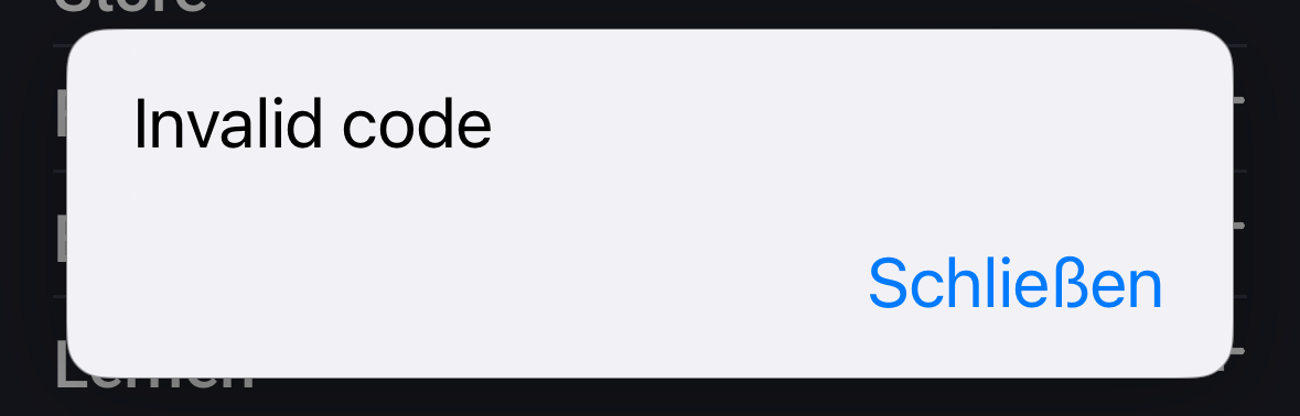

I can not login actually…
This happens when I try to Login at homey.app
:confused:

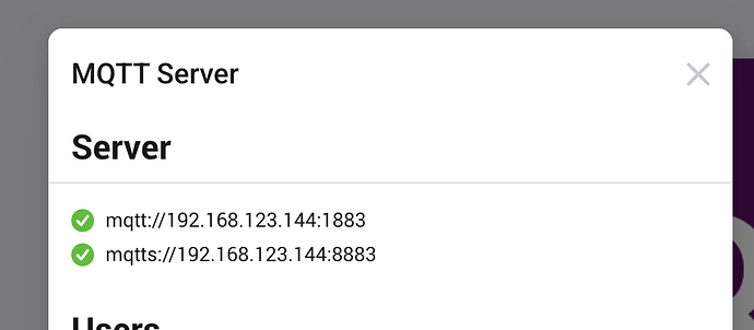

Im currently trying to connect a powermeter reader (WattWächter) to my HomeyPro. The device runs Tasmota 14.4.1 and has MQTT configured.
I already installed MQTT Server and MQTT Client on my HomeyPro. The configuration on my WattWächter seems to run:

When i try to add a Tasmota MQTT device i get: “No new devices found”
Have you also checked logs inside both to see if MQTT is passing trough ? At least for MQTT Broker and Client it’s possible.
I have no clue, how to check the logs the MQTT Server, but the client shows my devices:

Also in the local logs of the devices i can see successful connections.
I added the MQTT Server IP and Port settings from my Homey Pro on my HomeAssistant and it finds all of my devices! Why cant i get these devices be found in Homey pro? I would expect Tasmota device should be possible to add also on Homey pro … i dont see what i may have missed here.
