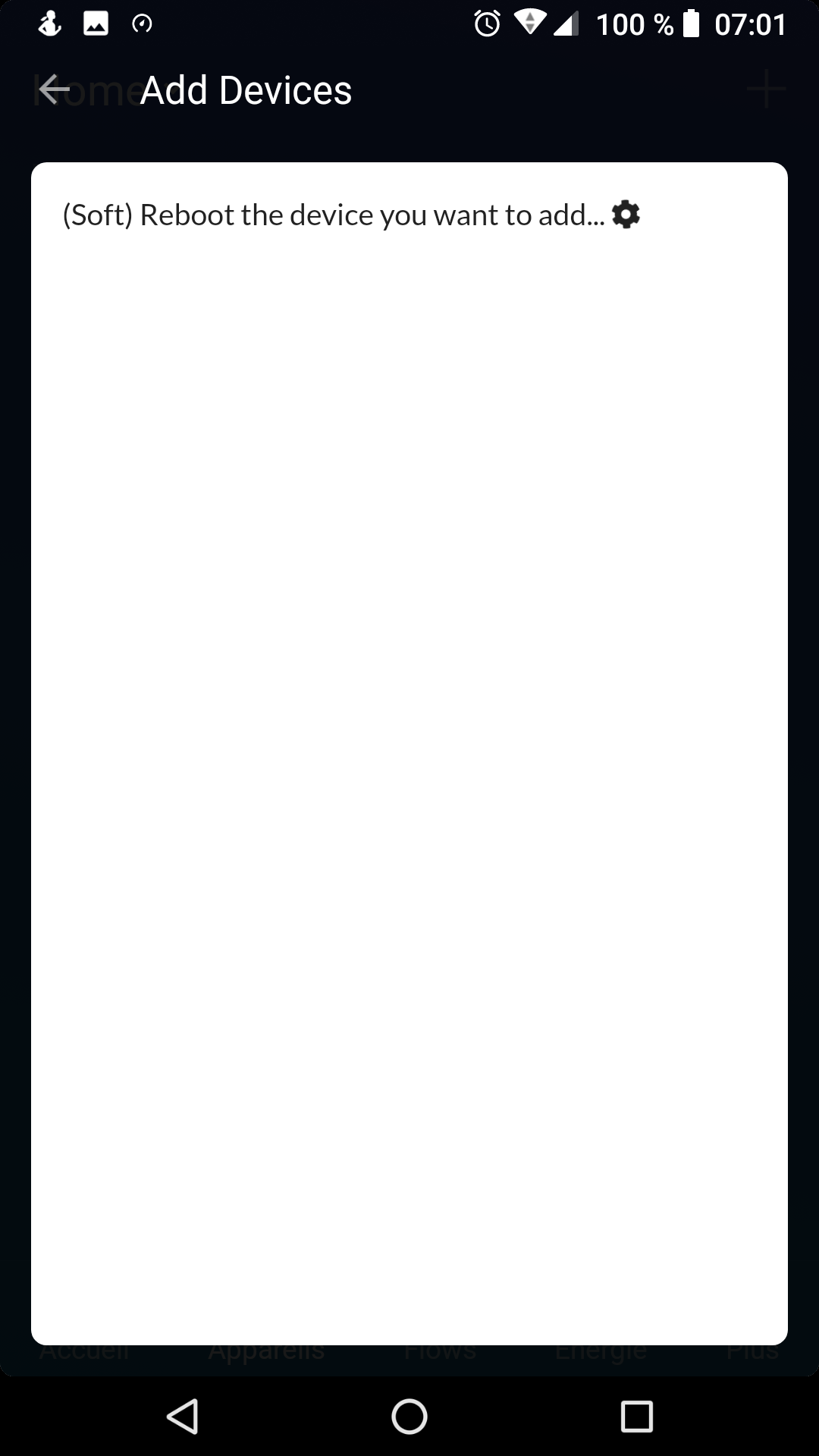

Hi, I can’t connect to my sonoff mini with the tasmota firmware. The procedure failed. In the MQTT (host) window, you must indicate the IP of my Homey Athom box or something else. In the Android Homey application, I installed the MQTT broker, with port 1883, it launches but tells me that it has disconnected from the client. when I install the GénéricTasmota application, the application expires. I put the IP of my Homey box in the Sonoff application. What to do ? Thank you for your help.
I restarted (smoothly) the device you want to publish
then the installation stops
First of all try to connect to your broker from your PC with client to see if your Sonoff configured properly to connect to broker. Also you MQTT client application should be installed on Homey and configured to communicate with broker. In opposite case Tasmota MQTT application will not work.
Attached are screenshots of the different stages which I access. Maybe there are errors? cordially

@Lionel I can see from your screenshot that you are using ITEAD Sonoff application to add a device. Mine application is Tasmota MQTT.

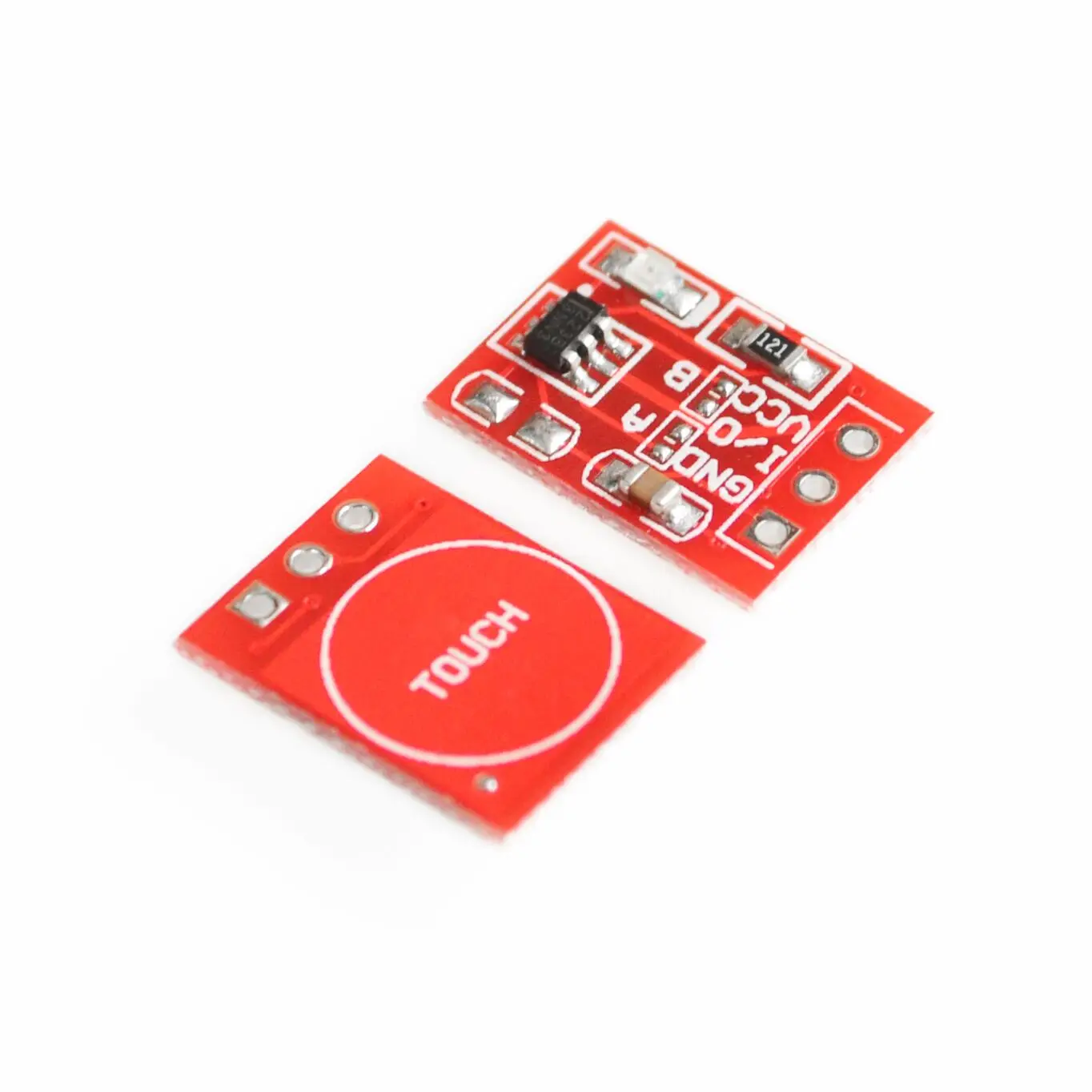

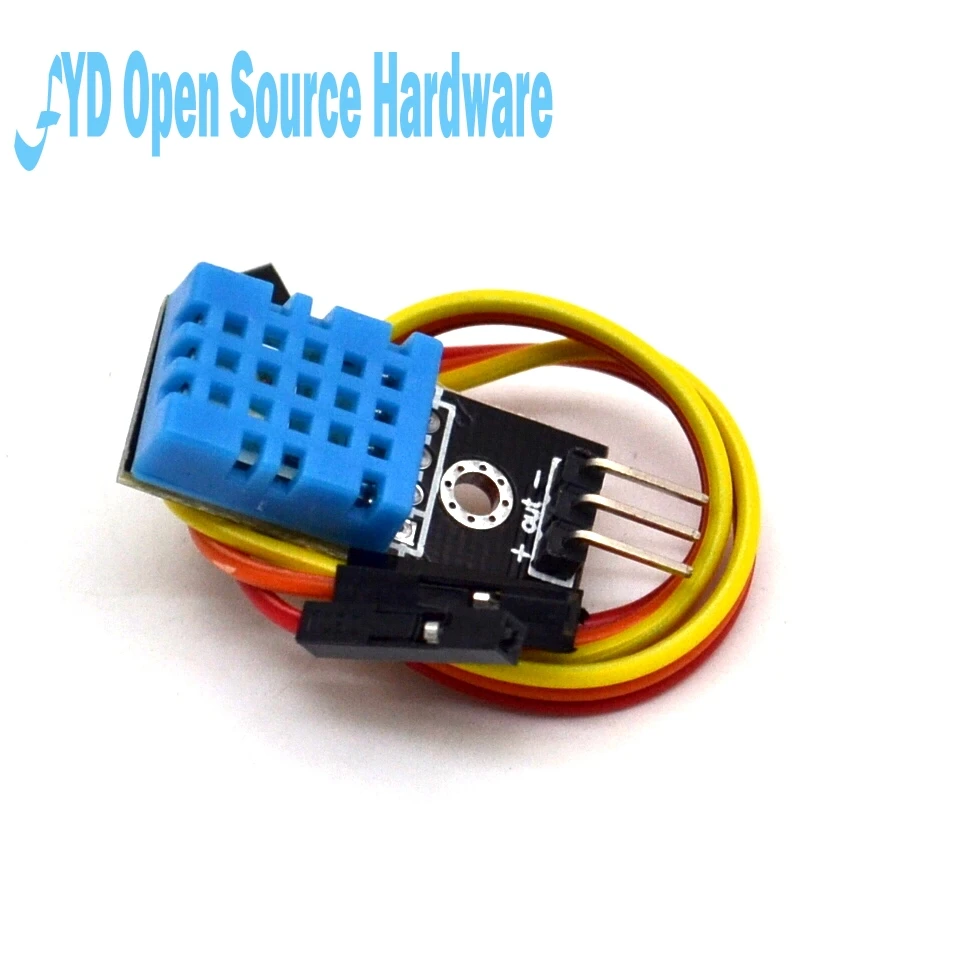

@SilverApe Will see what I can do. Can you meanwhile post me some examples of sensors and buttons with Tasmota support? I just never used any of them before. I will need to order some, and with all this virus situation it will take months to be delivered from China. So better to do it now.
@pavlo
I have ordered these (and more :wink:)
There are way more, I will see if I can find a list.
As for the waiting, I am still receiving my orders on time. Maybe some orders take a long time, but some don’t. I haven’t had any delays.
