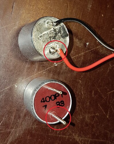

So I changed mine and seems we are back in operations. I kept all original pieces in place, including “white textil/paper grid” ? at the bottom of the sensor. It’s important to keep the right polarity, from the forum @Friedhofsblond shared, it’s mentioned.
I have ordered from Poland, cheaper then Aliexpress…
https://allegro.cz/nabidka/40khz-116db-400pt16-ultrazvukovy-snimac-13395296801
vs
https://vi.aliexpress.com/item/1005004720289431.html
