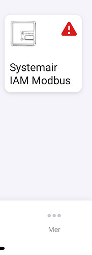

After update it doesn’t work anymore.
@Tom_D Try restarting the Systemair app
