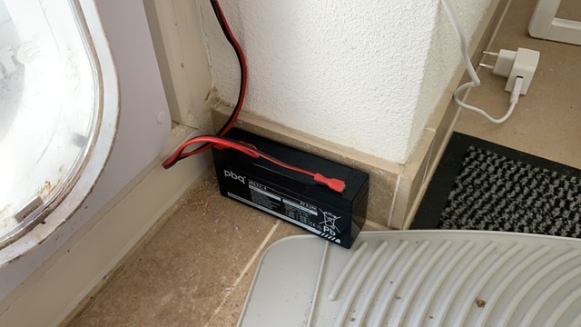

Since our catflap ran out of batteries within a month I also modified it to accept a larger Lead based 6 Volt accu. A netadapter was not advised because it might be too noisy, this works fine
image image
Depends what a member of bomb squad would say, if they see it I mean…
:grin: fair enough. I still need to make a nice enclosure
