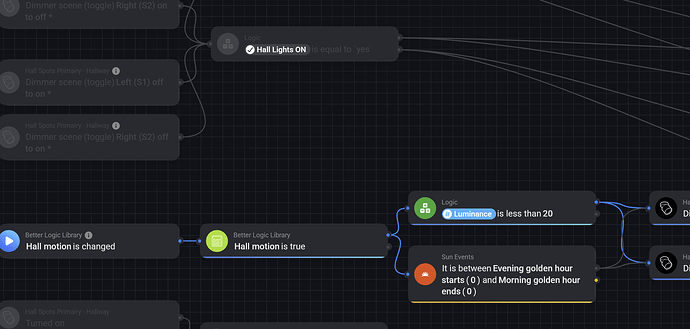

First of all thanks for this very nice app. I’m using it in quite some flows in order to turn ON/OFF lights all around and inside the house. So far happy.
But (of course) with on exception. I’m trying to turn on lights when there is motion between sunset and sunrise. But this only seems to work between sunset - 0:00 / in the morning before sunrise is does not trigger. The flow states it’s not between sunset and sunrise.
See my screenshot. I’ve extended the time a bit by using the golden hours. But either using actual sunset/rise or golden hour does not matter. In the morning it does not trigger. Anyone knows how to fix this?
Screenshot below is taken 2 hours before the Morning golden hour ends.
