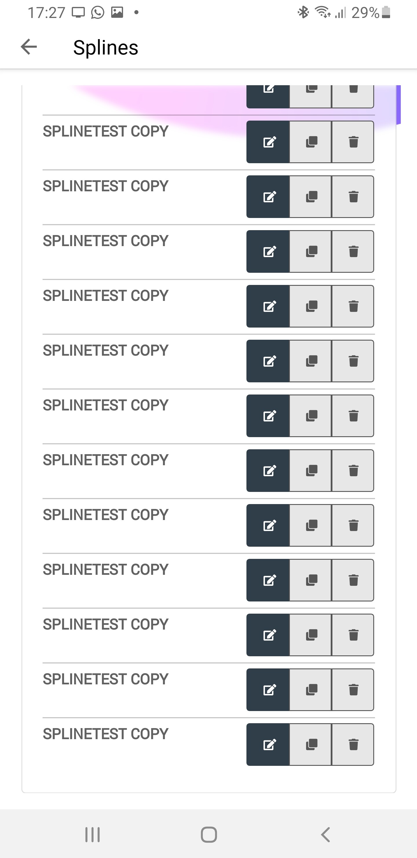

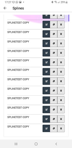

Philippe. Just installed test version 1.4.0. Tried to duplicate a spline. I can push the ‘copy’ button. it gets selected, nothing happens. I would suspect the new spline gets created, or it imports the settings into the ‘new’ spline when I push the Create button, but I don’t see that happening either. So not sure how it supposed to work.
It copies the spline and adds it at the bottom of the list, this is why you might have not seen it
But the copy only appears when you exit the app configuration and then go back to the app configuration.

I did not notice until I went back in, to see this…
:rofl:
Yes the copy function works, but not completely as expected… :upside_down_face:
