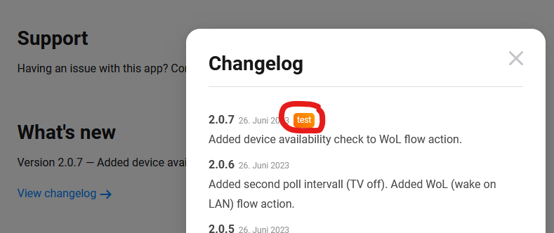

I only linked to the test version in first post about new test version above. You can use the app store URL with an added “/test” to get the test version:
Or open the changelog and click the TEST icon.
Thanks!
